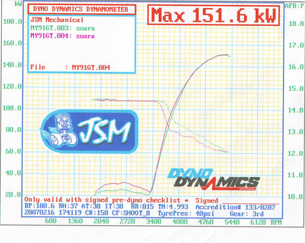

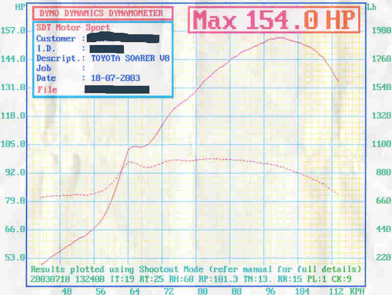

Hey guys well I have a V8 soarer and I've had some dyno's ran over the course I've owned it as well as before.
When I brought it I had a dyno ran back in 2003 and it's power figure was 114rwkw
Around end 2005 it had another one and made 124rwkw which converted into a 15.4sec pass at WSID.
22nd June 2006 had another run 135rwkw and that was after finding a blocked fuel line and fuel filter
I had one done yesterday and made 151rwkw after having the ecu repaired.
Unable to find the 2nd dyno sheet sorry guys guess you'll have to take my word on it, I have it on video somewhere.
Will post up sheet with the headers on next week.

Oh take note on the last two graphs with the air/fuel ratio's
Mark Northcott
UZZ30
Posts: 519
Saturday, February 17, 2007 - 04:45 pm, by:  Mark Northcott (My91gt) Quote hilighted text Edit Post Delete Post Print Post   View Post/Check IP (Moderator/Admin Only) Move Post (Moderator/Admin Only)
Oh for those who don't know the airflow is the bottom line on the last two. The other one is the power figure

Mark, the first graph looks like an engine with VVTi!

Yes the biggest thing that made me wonder if it had VVTi is look at the 105hp point, thats synonymous with the variable valve cam timing kicking in. Or VTEC in Hondas. Plus the AFR is quite rich! Man that thing was running thirsty in the upper RPM range too by the looks of things.
Another thing i have noticed is that you are comparing 3 different dyno results from 3 different machines. Thats a big no no when it comes to tuning. Golden rule, stick to one dyno machine for fairer and more realistic comparisons.

Yeah I know that :-) Scott's Dyno closed.
TM Autosports is on the Central Coast NSW
And I'm now living in Darwin... Bit hard now to use same dyno's
However here's a list of problems just quickly
We found a zip tie on a fuel line, blocked fuel filter (filter apparently was changed, big doubt) and the ecu had a list of faults.
Search for Bandiana to Palmerston fuel consumption you'll see how rich it was running :-)
I will be using the same dyno for the headers when they go on soon car is still there.

MMM good question, I'll have a look. It's in the V8 results but 90.18mph :-) So I was slower
However that'll be gone I was making around 154hp on that run, I'm now making 151rwkw.
