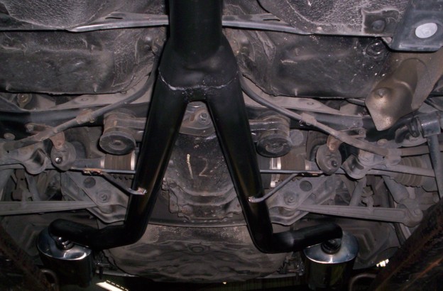

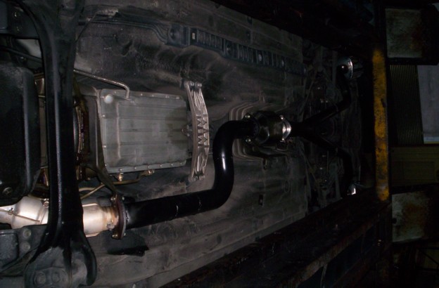

Here is some pictures I took on the day.

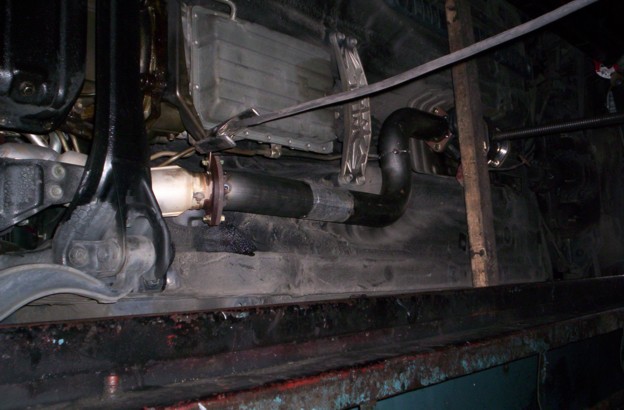

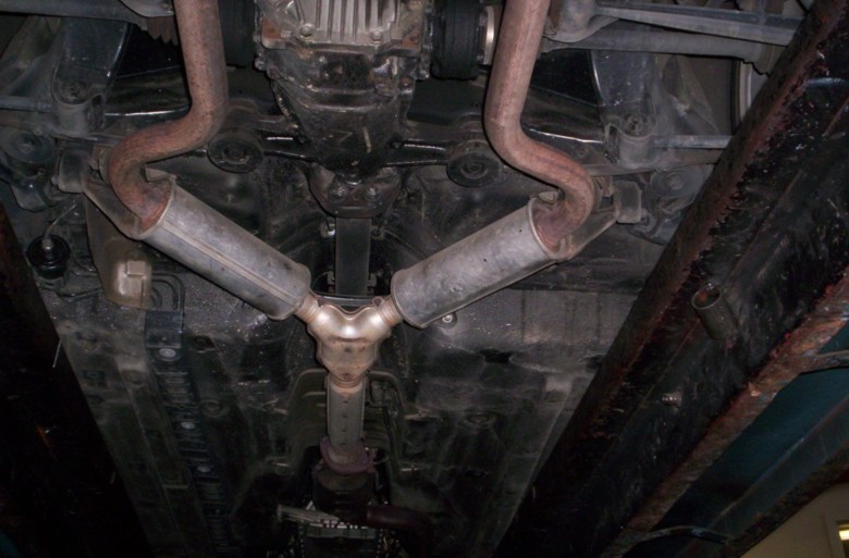

1. Before shot
2. Stock Pipe work (this got reduced to just the one bend on each side)

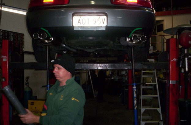

3. Sitting on hoist
4. Mendral bend slowly coming together
Aka Abedin
Posts: 245
Monday, July 10, 2006 - 01:10 am, by:  Aka Abedin (Soarer_91tt) Quote hilighted text Edit Post Delete Post Print Post   View Post/Check IP (Moderator/Admin Only) Move Post (Moderator/Admin Only)

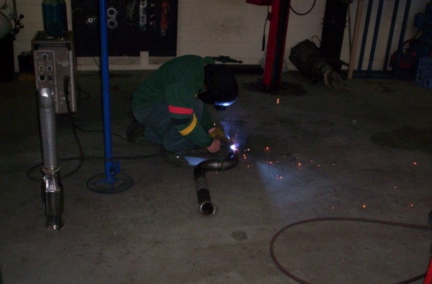

5. Front pipe getting put together

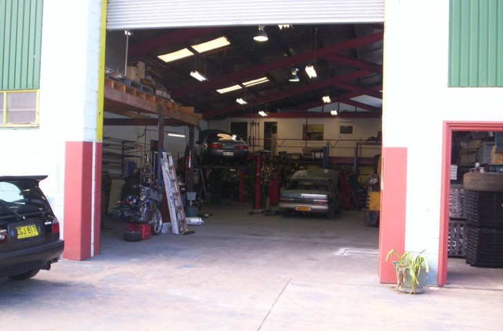

6. Here is the pic of the devil
7. Front pipe now welded to high flow cat and painted black
8. Back end LOOK how neat it is.

Looks good mate, Only 1 question.. Normally when you do an exhaust, you try and get some length from the dump pipe to the Cat.. MOst performance shops will recommend this. Your cat shoulda been put further down next to the gearbox ( in my opinion and from what i been told) Otherwise nice work.

Aka, nice exhaust setup mate, NO resonators? .

Daniel Clarke wrote on Monday, July 10, 2006 - 04:42 pm:
Hey Daniel, yes you are right in saying it should be closer. But if you look closely it is as close it can be. My digi cam is so the pic doesnt show the cat properly. Its sitting just behind the gearbox as soon as the bend straightens up the factory cat location. Bit hard to see in the pic but yeah its as close as he can get it.
Other problem was the cat is a bit on the fat side so he didnt have much room to bring it any close and then push it up towards the underbody roof.

NO resonators Cihan.
Its not 2 loud just PERFECT.

I have no resonators on mine, its only a 2.5 inch and the neighbours still complain :P

Cihan.. Yeha Man, you understood what i meant. Really need at least 18 inches of pipework before ya hit the cat. Found that out on a N/A 4 litre. Also goes for Turbos.

Tom specs are 3inch mendral bend of the factory dump pipes. If you look at pic number 4 you will see where it starts from (just after flex pipe).
So its 3inch mendral bend running into high-flow cat then "Y" split into 2.5inch press bend (no resonators).
Paul charged me $420+gst for the pipework, as i had the cannons & hiflow cat from before.
