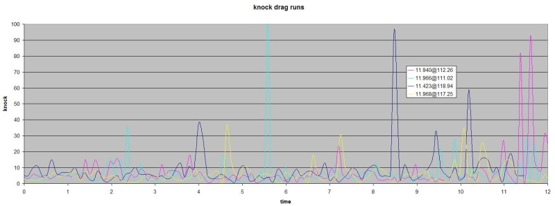

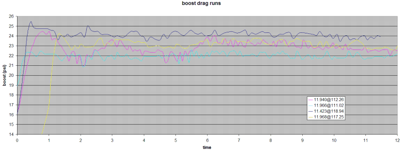

Towards the end of my drag racing I used Shell 100 and then put in wynns octane booster on top of that. My 11.4 run was this combo.
Ignition vs Time
Knock vs time
As you can see with the ignition graph, I ran a stupid amount of timing at high boost and rpm. Just at the 11.4 mark on the good run, shows around 20 degrees of advance, 24psi of boost and about 6600rpm on the tach. The knock values are pretty good, some spikes to 100 or so, but nothing constant which means it was just random engine noise, except for that pink 11.9 run got a little noisey at the end. I believe that run was only 98 ron fuel with booster.
Yep shell stuff is pretty good fuel, will it use to be, don't sell it any more from what i've seen.
