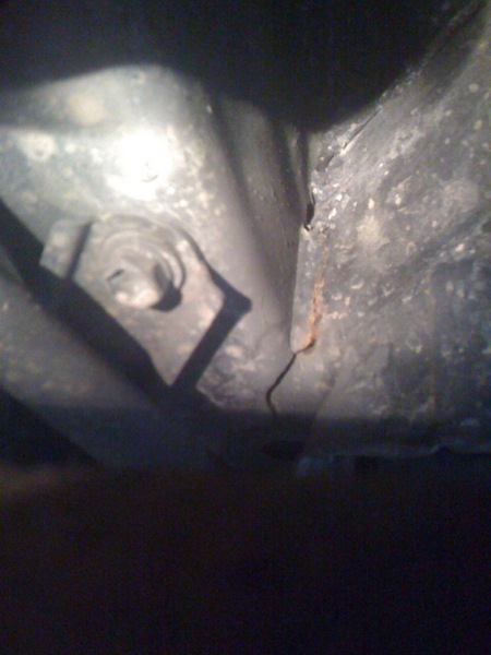

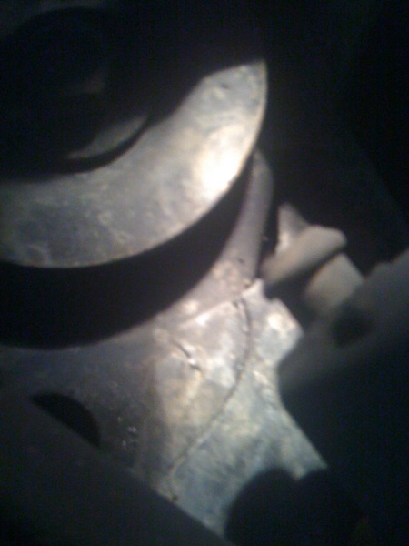

Well last week it was brought to my attention that my car was crab walking..... So I got one of my mates to follow me and tell me if it was true.... Well yep she is crabbing.... Spoke to Neil,Nial and a couple of members and all Idea's of what could it be.... Well the one who got the prize was Neil... Spot on!
You ask "Get to the chase Jeff" Ok ok ok here it is and it's shocking....
I have ripped away the sub frame from the chassis... Man I'm not happy... pic's as follows!
These 1st two pics are were the suspention joins the chassis

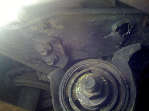

Last pic is the damage... The diff craddle(left side) that joins the chassis and the right side bracket also is cracked.... The cradle is just floating on the exhaust and this is why I Keep braking the exhaust mounts.....
I hope Nial can pull a biggie for me and have it read for track day.... Fingers crossed!

I recommend those that have had issue's with gutters! Check your mounts before this happens...
God knows how much this will cost to fix but it ain't looking good.... Really check them anyway.. If the brackets have cracks,Get them fixed asap!
