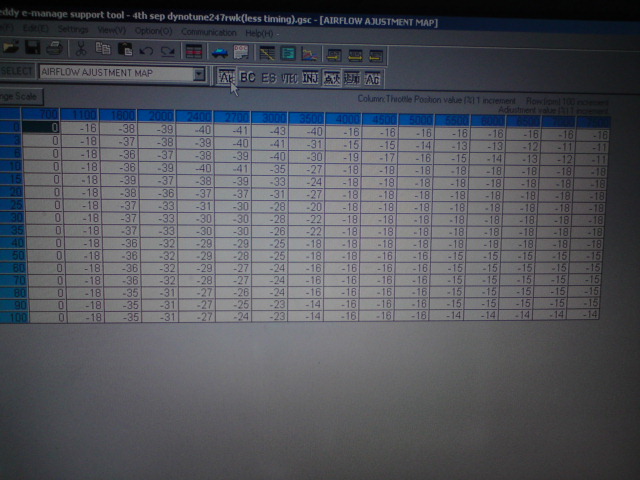

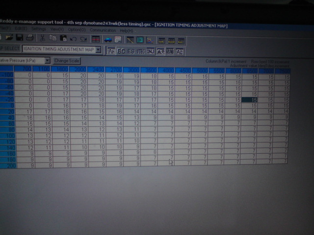

Tuesday, September 08, 2009 - 06:00 pm, by:  Pantelis Ataliotis (Prvjet) Quote hilighted text Edit Post Delete Post Print Post   View Post/Check IP (Moderator/Admin Only) Move Post (Moderator/Admin Only)
CIHAN this is what they did to my emanage maps please tell me what you think,.plus i had a kkr480 wich i took off before replacing it with a 430 to reduce lag now it dosen't feel as power
im almost beliving them when they say that thats juts how this engine is there excuse is,(small engine big car =no torque until 5000rpm)
anywya heres the maps

Tuesday, September 08, 2009 - 08:30 pm, by:  Cihan Aday (Cihan) Quote hilighted text Edit Post Delete Post Print Post   View Post/Check IP (Moderator/Admin Only) Move Post (Moderator/Admin Only)
Pantelis.
I won't openly express my opinion RE those emanage maps - it might offend someone with 30+ years of industry experience. Who knows, you can't tell these days.
So, to keep is simple here is what you need to do.
1- with the engine off and ignition on, start the connected emanage software, highlight all cells by pressing ctrl-a and press 0. Repeat until all modified maps on the emanage read 0. The fuel clamp menu should read 5.00 volts. Click Communication > export the map.
2- pop hood, from the fuse box near the battery, pull the 20amp EFI fuse for 5 minutes and replace.
3- undo the 4 hex bolts on the emanage front panel (flashing light side) and set the first three small edit: 'rotary dials' starting from the left to 7 4 0 in that order.
4- re-install OEM Toyota fuel pressure regulator and zip tie all vacuum hoses.
5- set boost to minimum gate pressure.
6- drop in a fresh set of BKR7E plugs. Confirm electrode gap of 0.8mm and change your oil.
7- start the car and drive it to someone who isn't fuel injection retarded for tuning.
All the best.

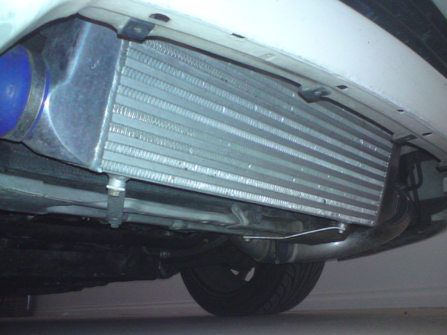

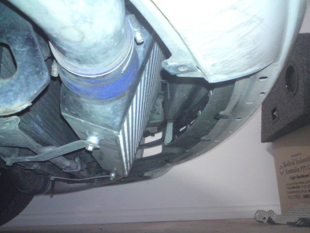

FIRSTLY, whoever mentioned the intercooler needs a good smack in the head! ITS NOT THE INTERCOOLER THATS THE PROBLEM!

by the way im glad its not the intercooler as well
i didnt think it was but you wonder sometimes when someone that does this for a living tells you things when they are meant to know..
