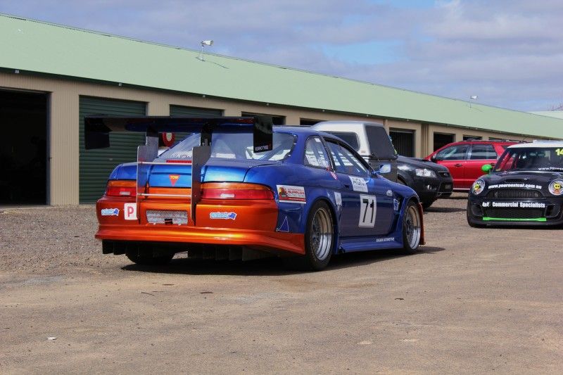

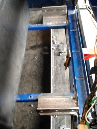

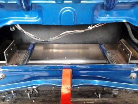

Got the wing finally positioned and installed today. Had to modify the uprights as although they were designed to clear the boot lid, I didn't allow for the boot lid to be taken off and put in with the mounts installed. You can see the difference in the photos above to the photos below. Also cut the slots in the rear bumper and it now fits really neatly on the car and around the wing mounts. I did a couple of fibreglass repairs to bits on the underside and inside of the bar, which is why I have no photo of it on the car yet, but it will go on no worries.
Here's some snaps from today (still with the crappy phone camera sorry):

That wing looks great!

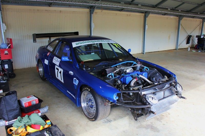

The weekend at Wakefield was good and bad. Good: set a PB. Bad: engine playing up chronically - fuel starvation or something yet to be diagnosed. What a pain.

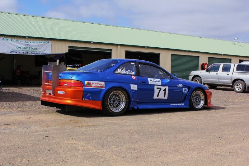

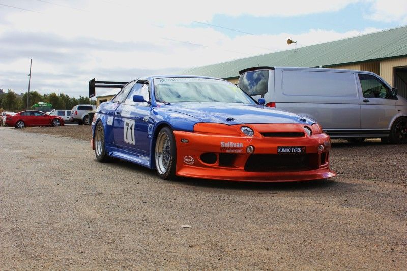

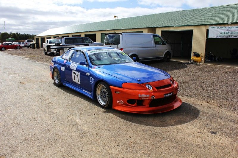

Meanwhile, here's some photos of how it looked before we went:

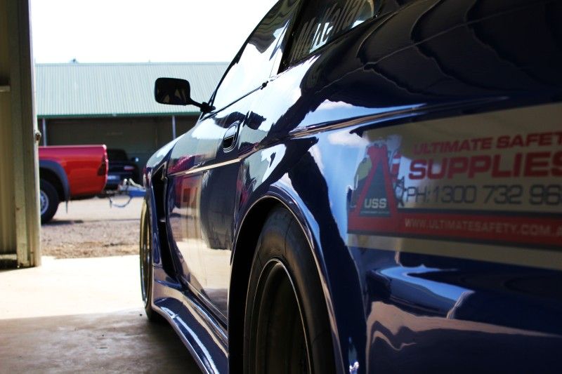

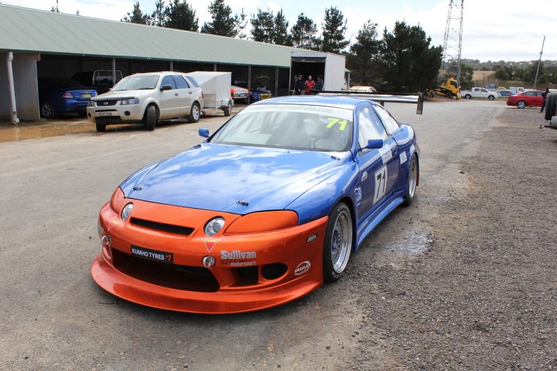

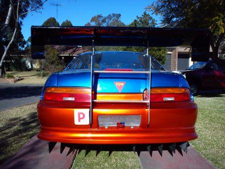

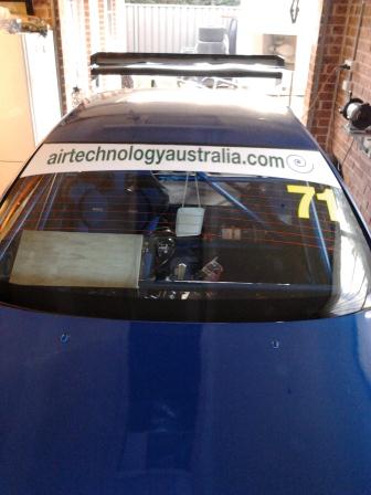

Nice work thanks Aaron. And thanks for the chat and helping out on the weekend too. Here's some more photos from Wakefield Park, courtesy of our friends at Koen Photo:

Whats with the P plate on the rear? is that a condition of racing?

The way those end plates sit, it looks like you are running a negative angle of attack. (I can see the wing profile and that tells me you aren't). In earlier photos the end plates were more horizontal- did you find you had too much rear wing, or is it just that the car was good enough with less wing and therefore you did not need the drag penalty?

Friday, August 17, 2012 - 08:27 pm, by:  Andrew McKellar (Toymax) Edit Post Delete Post Print Post   View Post/Check IP (Moderator/Admin Only) Move Post (Moderator/Admin Only)
Mark Peters wrote on Friday, August 17, 2012 - 07:50 pm:
Yes Mark. You have to do a certain number of events to maintain a full competition licence, or you drop back to a provisional one. Successfully complete 5 events in a 2 year period and you can upgrade again.
Ben Lipman wrote on Friday, August 17, 2012 - 08:06 pm:
We were experimenting a little, but in the end found the best drag-v-downforce setting was in about the middle. With the minimal amount of power we run, I felt we were losing a bit on the straight with the highest setting. And yes, the end plates don't sit exactly at the right angle, which was something also seen on the previous car that adorned it.
Andrew McKellar wrote on Friday, August 17, 2012 - 08:27 pm:
I know the wing is at the right angle, but the look of those end plates bugs the hell out of me, especially since the rest of the car looks so damn good.

Saturday, August 18, 2012 - 06:18 am, by:  Andrew McKellar (Toymax) Edit Post Delete Post Print Post   View Post/Check IP (Moderator/Admin Only) Move Post (Moderator/Admin Only)
Beggars can't be choosers. We'll fix it when we make our own wing.

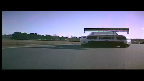

Sunday, August 19, 2012 - 08:16 pm, by:  Andrew McKellar (Toymax) Edit Post Delete Post Print Post   View Post/Check IP (Moderator/Admin Only) Move Post (Moderator/Admin Only)
Here's the video of our qualifying lap at Wakefield Park last week. More videos to come when I finish working through editing them...

Thursday, August 23, 2012 - 05:15 am, by:  Andrew McKellar (Toymax) Edit Post Delete Post Print Post   View Post/Check IP (Moderator/Admin Only) Move Post (Moderator/Admin Only)
You can also catch glimpses of the Soarer from on board this Corvette C6 in these 2 videos:
