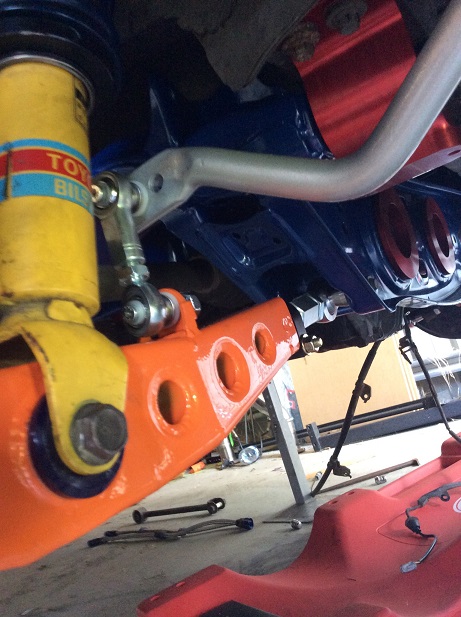

the offending toe control mount.
subframe after welding, grinding and blasting again and crack tested.
removing the bushes after powder coating
and the subframe powder coated with solid bushes fitted
Damon Cornish
Posts: 129
Reg: 03-2009
Saturday, December 19, 2015 - 02:33 pm, by:  Damon Cornish (Boz) Edit Post Delete Post Print Post   View Post/Check IP (Moderator/Admin Only) Move Post (Moderator/Admin Only)

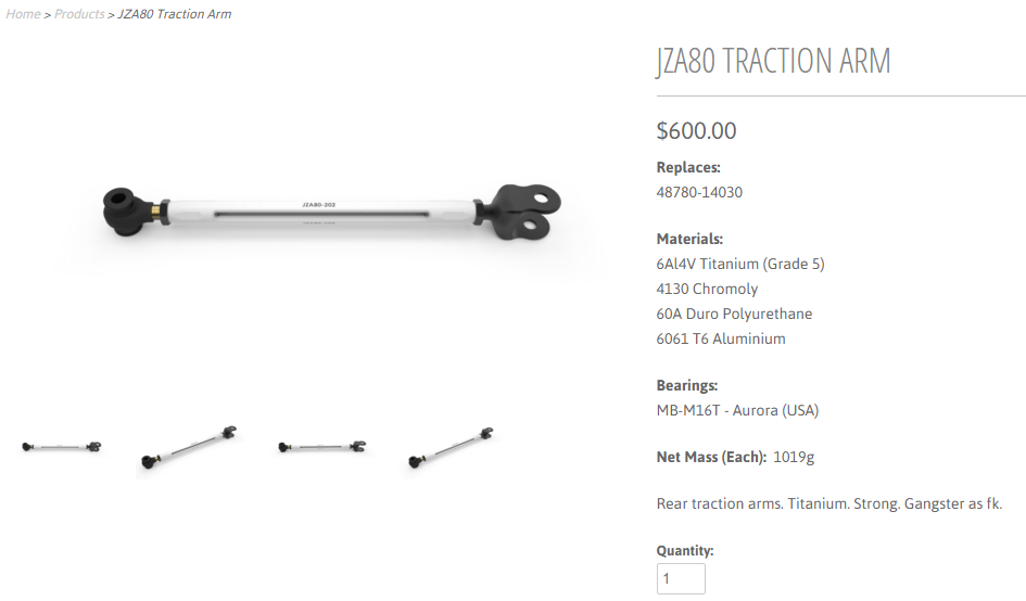

The Figs engineering rear lower control arms, adjustable toe control arms and solid sway bar links. these feel like a heavy duty bit of kit.

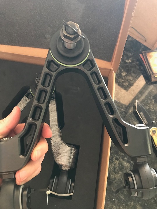

I have also brought what are possibly the ultimate in adjustable rear upper control and traction control arms. these haven't been delivered as yet so i've taken screen shots of them also. pure porn.

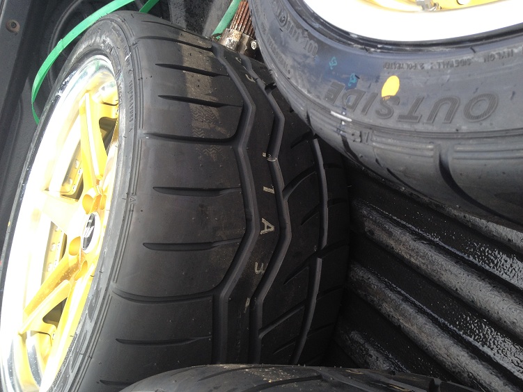

I was able to justify these as the old rims wouldn't clear the LS400 calipers
Work Zeast st1 9.5" fronts by 3 and 10.5" rears by 2. shod in Falken RT615K 265/35R18 and 315/30R18 respectively

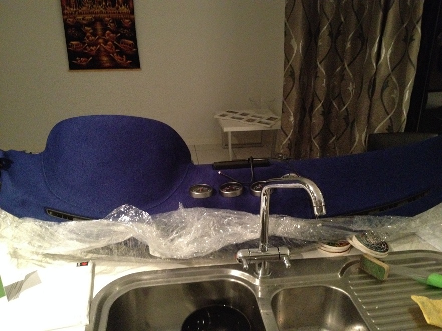

And the test fit for the dash mods. I'm pretty happy with them just a couple of tweaks then it will be covered in leather and the refit and wire up can start......hopefully over Xmas......we'll see.
the gauges will sit a little more vertical than they appear in the photo.
No I haven't put the stereo head unit in the dash. It's an OLED single DIN triple gauge measuring OIL pressure and temp and coolant temp. The gauges above it will be from closest to the steering wheel Boost, Fuel pressure, intercooler fluid temp and dual AFR. There will also be a tranny oil temp gauge and fan/pump switch somewhere near where the coin tray and cigarette lighter used to be...
More photos when I find them or once I've made a little more progress.

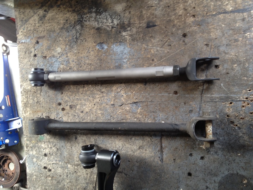

some old/new side by side shots

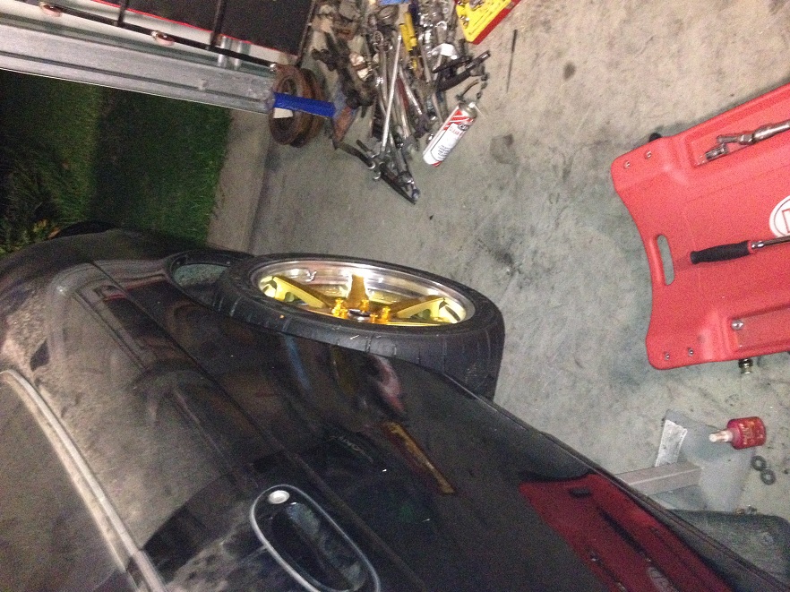

wheel fitment, wont be adjusting ride height/ suspension until the bodykit is fitted

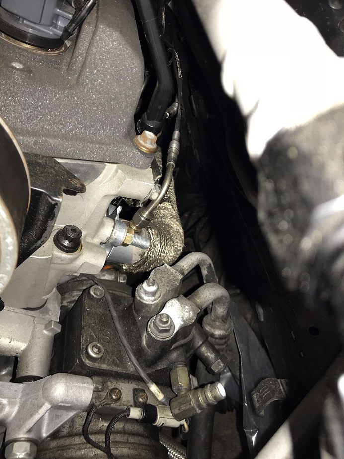

changed from a coolant level sensor to a coolant pressure sensor. if you look close you can see the new alt fitted and a couple of other changes.

Love the wheels. What offsets did you go with ? I gather they need the guards rolled ?
Damon Cornish
Posts: 153
Reg: 03-2009
Monday, July 23, 2018 - 02:29 pm, by:  Damon Cornish (Boz) Edit Post Delete Post Print Post   View Post/Check IP (Moderator/Admin Only) Move Post (Moderator/Admin Only)
thanks Mark,
offset is +48 front and back.
front and rear guards will be getting some work when the bodykit goes on.
