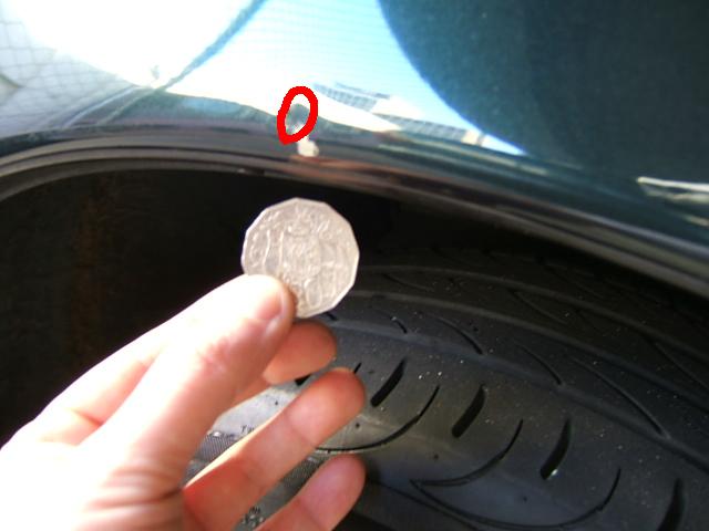

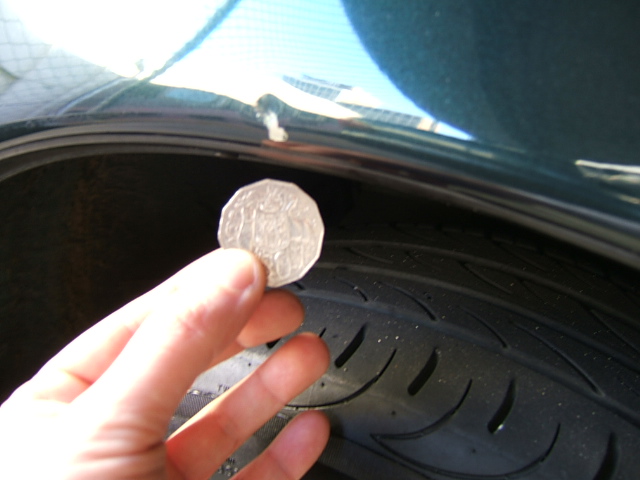

Monday, August 01, 2005 - 02:29 pm, by:  Steve Millward Quote hilighted text Edit Post Delete Post Print Post   View Post/Check IP (Moderator/Admin Only) Move Post (Moderator/Admin Only)
Here is a photo of the chip. The dent is not really visible given the paint colour and the light, but you can see how the reflected light is distorted above the chip. The dent is just to the left and about 1cm long. I'm not hopeful of this just popping out given that it's next to the edge of the guard.
Any further thoughts gents?

Monday, August 01, 2005 - 05:57 pm, by:  Jeff Wilkins Quote hilighted text Edit Post Delete Post Print Post   View Post/Check IP (Moderator/Admin Only) Move Post (Moderator/Admin Only)
That should be spot repairable without to many problems Steve.
If the dent is actually across the crown of the guard (hard to see in the pic) it will take a bit of fiddling to pop it back out. If its not actually the crown thats dented, the strength of the crown will actually make it easier to push the dent out.
Good luck.

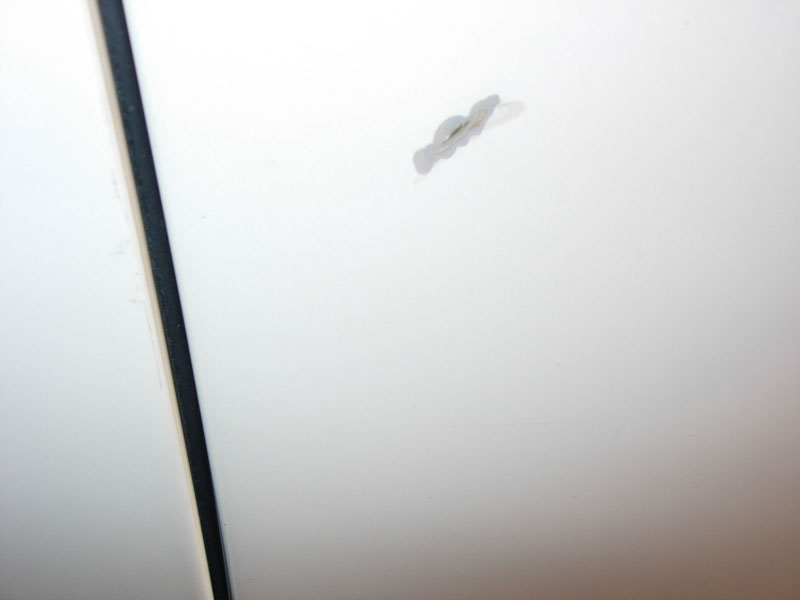

Posts: 23
Monday, August 01, 2005 - 07:42 pm, by:  Daniel Lee Quote hilighted text Edit Post Delete Post Print Post   View Post/Check IP (Moderator/Admin Only) Move Post (Moderator/Admin Only)
My rear left quarter panel got a pretty deep scratch and got a quote for $500 to repair the damage...
Here is the pic:
As you can see the scratch is pretty small but the workshop say pearl white is really hard to match and they need to respray the whole panel..
So now i still havent got the fix...
Jeff Wilkins
JZZ30 GT-TL
Posts: 30
Monday, August 01, 2005 - 08:25 pm, by:  Jeff Wilkins Quote hilighted text Edit Post Delete Post Print Post   View Post/Check IP (Moderator/Admin Only) Move Post (Moderator/Admin Only)
Be assured that they arent shitting you. Patching pearl aint worth it. Ive never seen anybody get it perfect, close, but not perfect.
Steve Millward
Posts: 9
Tuesday, August 02, 2005 - 10:40 am, by:  Steve Millward Quote hilighted text Edit Post Delete Post Print Post   View Post/Check IP (Moderator/Admin Only) Move Post (Moderator/Admin Only)
Jeff, what's the best way of popping the dent out? The dent is on the flat bit just above where the guard curls underneath, within the red line on this photo?
Will the touch up guy push the dent out, or should I fiddle around and try to push it out from behind?

Jeff Wilkins
JZZ30 GT-TL
Posts: 34
Tuesday, August 02, 2005 - 03:55 pm, by:  Jeff Wilkins Quote hilighted text Edit Post Delete Post Print Post   View Post/Check IP (Moderator/Admin Only) Move Post (Moderator/Admin Only)
Its probably best left to somebody that knows what theyre doing Steve (no offence intended, I obviously have no idea in regard to your metal finishing experience). The dent looks to me like it should push out pretty well with a nice round headed twist bar but if you start pushing up in the wrong spot youll end up with a mess that is nightmare to get straight without resorting to filing.

Wednesday, August 03, 2005 - 04:37 pm, by:  Jeff Wilkins Quote hilighted text Edit Post Delete Post Print Post   View Post/Check IP (Moderator/Admin Only) Move Post (Moderator/Admin Only)
If the dent is 'spiked' out instead of pushed or levered there is a chance of cracking (hell on old paint theres a chance of cracking regardless) but Id not be too concerned about that. The crack would only be small, the area needs to be sanded back with or without the (possible) crack so it makes no difference whatsoever.
Providing your repairer can match the paint then nobody will ever know it was there.
