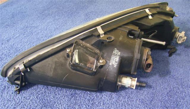

Does anyone know of a reason not to seal up the little vent holes in the back of the headlights??
Norfolk Island
Posts: 280
Sunday, October 30, 2005 - 11:50 pm, by:  Mike Triggs (Mikeandimah) Quote hilighted text Edit Post Delete Post Print Post   View Post/Check IP (Moderator/Admin Only) Move Post (Moderator/Admin Only)
Yes, Dan, they're to let condensation out, in theory. The heat inside should expand the air inside forcing any moisture out- though the vents. Headlights should never be sealed up tight, to allow for that expansion and contraction.
Posts: 2230
Sunday, October 30, 2005 - 11:51 pm, by:  Peter Nitschke (Pen) Quote hilighted text Edit Post Delete Post Print Post   View Post/Check IP (Moderator/Admin Only) Move Post (Moderator/Admin Only)
Possibly they allow the housing to breathe, eg when the lights are on, the air will heat up and expand, then contract again when cool. Put a small wad of foam in them - which is normally in the rubber S tube attached to those outlets.

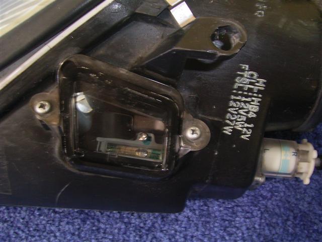

Wait until you see the cool little spirit level under the site glass on the sc lights Mike. They are pretty cool hehe.

Oh Perry...............Everyone knows about the spirit levels, I mean,....Dude.....that is Soooo "Last century"

"If the line goes out of the blue area, return the vehicle to your lexus dealer for repairs"

Sorry for the old post guys, but Dan your last statement about the headlight:
what is this for? and is it a serious issue?
UZZ-32 V8 Soarer #138
Posts: 448
Saturday, December 03, 2005 - 12:18 am, by:  Dan McColl (Hoon) Quote hilighted text Edit Post Delete Post Print Post   View Post/Check IP (Moderator/Admin Only) Move Post (Moderator/Admin Only)
Sorry Tom. It was a joke regarding the US spec headlights. Thats what it says in the lexus SC400 owners manual.
It's not an issue at all, sorry for any confusion I may have caused. :-)
