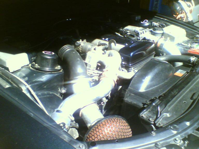

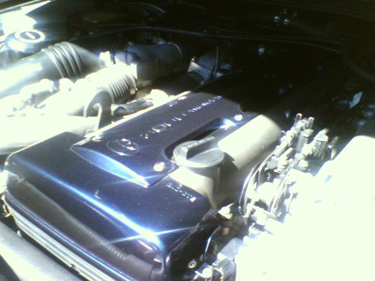

Ok. Took some pix with my phone just to show those interested.
high resolution images also available throughout the conversion which show most of the loom bits which had to be modified (only about 3 single wire plugs) took 30sec each. If anyone wants those let me know and ill get them off my mates camera and e-mail them to you when i have time.
The aircon and the alternator also had to be swapped over. A new accelerator bracket had to be made. (pretty easy too). Everything else was pretty much straight forward including the cooler piping.
Performance: well it feels like it goes just as hard as my 1j with 16psi and an e-manage (227rwkw). Only difference is that the car is now running on stock 1jz computer with no e-manage and on 10psi with stock supra dumps. Off boost response is unbelievable. The turbos no longer need to go into positive pressure when going up hill and yet the car is pulling just as hard. Flat sticking it off the line with out holding the brake has also changed. The 1jz used to struggle till it reached 2500-3000rpm then all hell broke loose. With the 2j the car moves a lot easier. The power delivery seems pretty much constant altho the turbos kick in a bit later then on the 1j. This is not noticeable due to the 3L bottom end.
Top end, it doesnt loose any grunt it keeps pulling even after 130. The sound is a bit deeper and it flutters similar to a slightly modified nissan. Thats cos i dont have a BOV yet and the stock one was blocked off.
A special thanx to two good friends of mine at BAR Mechanic, Barry and Sammy whos workshop and tools i used and who did most of the labour for free and supplied parts at cost price.
Thanx guys.
Also I'd like to thank Manny, Andrew and Simon for putting up with and answering a ton of questions, some pretty stupid ones too and for giving me well needed advice along the way.
Thanx!!!
Whats next you ask?
Engineers certificate, then crank it up where ever possible to get as much as possible out of it.
Dragan

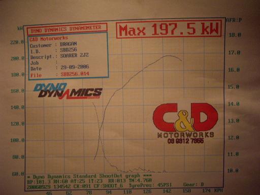

Dragan Vidic
soarer tt
Posts: 628
Saturday, September 30, 2006 - 10:25 am, by:  Dragan Vidic (Soarer_ttt) Quote hilighted text Edit Post Delete Post Print Post   View Post/Check IP (Moderator/Admin Only) Move Post (Moderator/Admin Only)
10PSI and torque is at the flywheel
Troy Baker
Carnarvon WA
Soarer HKS Single Turbo
Posts: 154
Saturday, September 30, 2006 - 06:47 pm, by:  Troy Baker (Sincity) Quote hilighted text Edit Post Delete Post Print Post   View Post/Check IP (Moderator/Admin Only) Move Post (Moderator/Admin Only)
Running very rich too, definitely some scope for improvement there.
