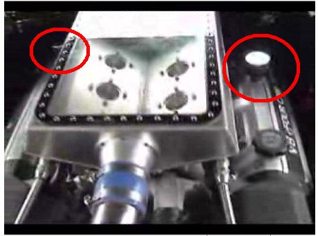

http://www.youtube.com/watch?v=3ZwM8P-G38I&mode=related&search=
MANUAL Super Charged UZZ31 :-)
Posts: 2749
Friday, October 06, 2006 - 09:18 pm, by:  Neil Griffiths (Aussiesc) Quote hilighted text Edit Post Delete Post Print Post   View Post/Check IP (Moderator/Admin Only) Move Post (Moderator/Admin Only)
Another one with NO Crankcase Ventilation :-(

Friday, October 06, 2006 - 11:32 pm, by:  Blaine Hanson (Blaine) Quote hilighted text Edit Post Delete Post Print Post   View Post/Check IP (Moderator/Admin Only) Move Post (Moderator/Admin Only)
Neil, it looks to me like they have small vents on both sides - like breathers.

Toyota motors like a bit of crankcase suction though, right?
Posts: 2751
Saturday, October 07, 2006 - 08:43 am, by:  Neil Griffiths (Aussiesc) Quote hilighted text Edit Post Delete Post Print Post   View Post/Check IP (Moderator/Admin Only) Move Post (Moderator/Admin Only)
Correct Miles.
If an engine didnt need a PCV, then why would engineers include it in the first place ?
In the the old days it was called a Fume Pipe, BUT, they didnt have anywhere near the amount of pressure in them.

very nice... thought could of put trups on the inlets

That's one heck of a noisy supercharger.

Trumpets not needed as its Forced induction Savo. Thr trumpets would probably only hinder airflow inside the box with forced air trying to get up and over the trumpets i assume.
Different in a N/A car, where the trumpets help with airflow.

true, but low trups wont harm force induction( just to smooth flow into the chambers), to me the inlet pipes dont looked smoothed off may be the pic you cant really tell.
