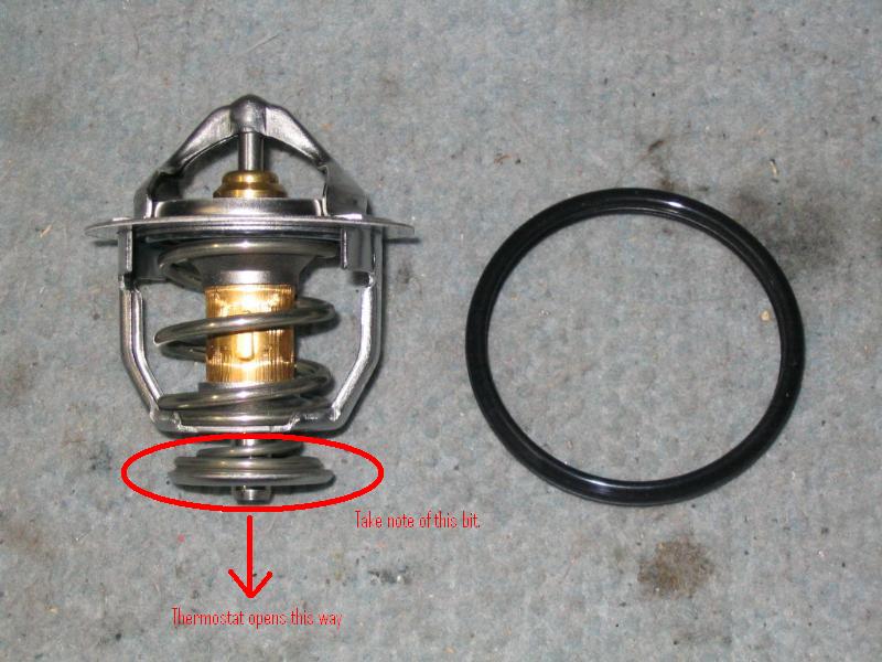

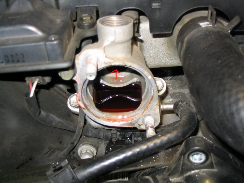

In the first pic. Note the little flat bit on the back of the Thermostat.
When the thermostat opens this little flat bit goes back into this hole (with the arrow) and blocks it off, also it opens the main thermostat valve allowing water OUT OF the radiator.
When the thermostat is closed, it blocks the big hole to the radiator and opens the little one at the back, allowing water to keep circulating to prevent localised hot spots and also to prevent cavatating in the water pump.

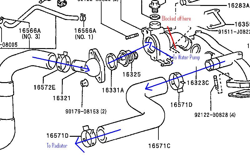

Some more diagrams to help with understanding.
The first one is water flow when cold and thermostat closed.
The next pic is water flow when hot and the thermostat open.
Also note that there are many in betweens with the thermostat partially open which would result in part of the flow bypassing the radiator and part going through it.
Any way. You can probably figure out that with no thermostat in there, you would have no control over the bypass and would have water flows going in directions they're not meant to go, which could have some bad results.
It may be fine, But I'm not going to try it out.
Also note that the thermostat is on the return line from the radiator, rather than block the flow to the radiator it blocks the return flow from it. I would guess that this is to keep the Bubble tank / Expansion bottle working properly.
