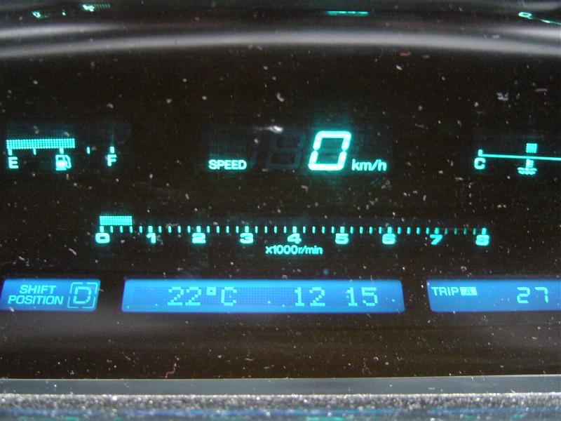

Soarer VVTi
Posts: 1046
Wednesday, December 13, 2006 - 01:52 am, by:  Jose-Antonio Castillo (Ahh_soarer) Quote hilighted text Edit Post Delete Post Print Post   View Post/Check IP (Moderator/Admin Only) Move Post (Moderator/Admin Only)
Bottom part of the dash will all be digital compared to the pov-pack (in the auto models anyway)
Here's a lux-pack dash.

Wednesday, December 13, 2006 - 02:05 am, by:  Scott Ferguson (Scott_ferguson) Quote hilighted text Edit Post Delete Post Print Post   View Post/Check IP (Moderator/Admin Only) Move Post (Moderator/Admin Only)
But the outside temp function was only a limited thing from 92 on wasn't it? I have the digital bottom row but no temp.
So I'm pretty sure that I have the Luxo Dash.
