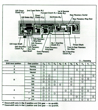

So what is this B1 second coast brake?

Benjamin Burgess
Toyota Soarer GT-TL, Toyota Corolla Conquest
Posts: 1419
Sunday, June 03, 2007 - 09:42 pm, by:  Benjamin Burgess (Jampac) Quote hilighted text Edit Post Delete Post Print Post   View Post/Check IP (Moderator/Admin Only) Move Post (Moderator/Admin Only)
So is this mechanically enabled or can it be electrically triggered?

Sunday, June 03, 2007 - 09:50 pm, by:  Denys Hobbs (Denys) Quote hilighted text Edit Post Delete Post Print Post   View Post/Check IP (Moderator/Admin Only) Move Post (Moderator/Admin Only)
mechanically i would think as it only seems to come into play when the stick is moved into 2 or low.
The blue pill or the ultimate pill, make your choice.
Posts: 2005
Sunday, June 03, 2007 - 10:10 pm, by:  Cihan Aday (Cihan) Quote hilighted text Edit Post Delete Post Print Post   View Post/Check IP (Moderator/Admin Only) Move Post (Moderator/Admin Only)
http://www.autoshop101.com/forms/AT21.pdf
According to the autoshop article regarding Toyota transmissions, B1 is used to allow deceleration engine braking (as we know)..
Also, the 2nd coast brake and the F1 one way clutch have to work together. So B1 is not active unless the one way clutch is in use.
Good read if its relevant.

Sunday, June 03, 2007 - 10:26 pm, by:  Denys Hobbs (Denys) Quote hilighted text Edit Post Delete Post Print Post   View Post/Check IP (Moderator/Admin Only) Move Post (Moderator/Admin Only)
arrr yes thats the puppy (Won't give you deceleration fuel cut however) No but this is how you have more engine braking in second gear compared to the suprastick.
Benjamin Burgess
Posts: 1420
Sunday, June 03, 2007 - 10:35 pm, by:  Benjamin Burgess (Jampac) Quote hilighted text Edit Post Delete Post Print Post   View Post/Check IP (Moderator/Admin Only) Move Post (Moderator/Admin Only)
but this is only when you use the shifter.
Benjamin Burgess
Posts: 1421
Sunday, June 03, 2007 - 10:38 pm, by:  Benjamin Burgess (Jampac) Quote hilighted text Edit Post Delete Post Print Post   View Post/Check IP (Moderator/Admin Only) Move Post (Moderator/Admin Only)
so I thinking if you could enable this you could in theory keep the torque converter locked up in 2nd gear with no throttle applied.

Sunday, June 03, 2007 - 10:41 pm, by:  Denys Hobbs (Denys) Quote hilighted text Edit Post Delete Post Print Post   View Post/Check IP (Moderator/Admin Only) Move Post (Moderator/Admin Only)
(but this is only when you use the shifter)
Yes seems so.

Monday, June 04, 2007 - 09:07 am, by:  Benjamin Burgess (Jampac) Quote hilighted text Edit Post Delete Post Print Post   View Post/Check IP (Moderator/Admin Only) Move Post (Moderator/Admin Only)
Yeah thats right decel fuel cut works different. For me when the suprastick drops the gear from 4th to 3rd with no throttle applied it unlocks the converter changes to 3rd then it says it has relocked the converter. However what you get instead is this engine braking like effect which is not the same as with the converter locked. You do get some decel fuel cut, but no were near as much decel fuel cut as you do when the converter is locked up correctly in 3rd gear. Basically what I get in 3rd (Just needs throttle applied once to lock correctly, and it stays locked when off throttle) and 4th is what a manual transmission does. What you get from a normal auto setup is some in between like setting, that isn't fully locked, but no free reving like it is for us in 2nd gear.
Benjamin Burgess
Posts: 1423
Monday, June 04, 2007 - 09:28 am, by:  Benjamin Burgess (Jampac) Quote hilighted text Edit Post Delete Post Print Post   View Post/Check IP (Moderator/Admin Only) Move Post (Moderator/Admin Only)
Just found the section on page 28 where it says engine braking is only applied in 2nd gear when the shifter is in 2nd gear position, don't get it when shifter in D. I think for me however due to the looser converter it may play around with how much engine braking effect I get.
What still doesn't quiet make sense however if this is hydraulically engaged then how come if I put the shifter in 2nd, i don't get the brake effect with the suprastick engaged? I'm pretty sure I don't.

Monday, June 04, 2007 - 09:48 am, by:  Denys Hobbs (Denys) Quote hilighted text Edit Post Delete Post Print Post   View Post/Check IP (Moderator/Admin Only) Move Post (Moderator/Admin Only)
can't try mine as i have bits stripped off to put new timing belt on, go here page 30
http://www.autoshop101.com/forms/AT25.pdf

Denys Hobbs wrote on Sunday, June 03, 2007 - 10:26 pm:
Also why i could probably lock 2nd with zero throttle too. Since the one way clutch is enabled, i shouldn't have any problem forcing the lockup on with 12v in 2nd gear and little or no throttle.

I've heard from dennis with the 2jz skyline, he did this and got strange results, wasn't the same as the suprastick as you can't unlock on gear change (you'll stuff the transmission if you keep it locked).
I suspect then that the suprastick is actually locking the stall converter (it indicates it's locked) but with the B2 hydraulic valve not enabled, it free revs in the gearbox.

Ok went for a quick drive around the block tonight and yep it works. If you put the shifter in L (1st) it'll engine brake if the suprastick is held in 1st gear and locks the converter and does fuel cut on decel. The same occurs for 2nd gear on the suprastick and 2nd on the shifter. So how do we implement this?
I was thinking have a switch that goes 12v when ever the shifter is moved to 2nd or L or OD is switched off that changes the suprastick to manual mode automatically. The next thing you need is a method to tell the suprastick what gear you are in on the shifter. The suprastick has two configurations, for manual shifting. Two buttons for up and down or one button for up and down that has two seperate voltages ie. the cruise control stick. How you would do this without making a circuit to output the correct signals, I have no idea, so looks like I'll need to sit down a draw a circuit to do this.
Now the next question is, could you implement an up down switch that would also move the shifter or something in the gearbox to enable the right valves for the correct gear?

ok well done, i have seen some thing thats used on motor bikes to move the shifter by electronics, i will have a search around.

The coast brake, as you have discovered is purely mechanical. I have thought about including a linear actuator setup to throw around the stock linkage, but the problem is these are not cheap. If someone has the parts, the programming side of this is easy.
The 5% throttle lockup drop that you are seeing is hardcoded - I can get rid of it, but i had bad experiences during testing with things staying locked at 0 throttle. If your lockup clutch is built enough that it will take the possible abuse of this, that limit can be removed.
