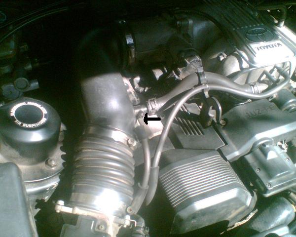

Hello everyone,

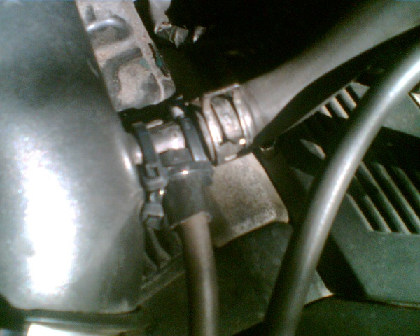

Over the weekend I noticed a small hose near the air intake had broken away from it's T piece connector.
Can anyone please identify this hose and it's function?
For the time being I have used cable ties, however the connection is no longer air/water tight.
Thanks All!
Mercedes Benz SLK230 Kompressor
Posts: 7078
Monday, September 22, 2008 - 04:25 pm, by:  Don Bagnall (Baggs) Quote hilighted text Edit Post Delete Post Print Post   View Post/Check IP (Moderator/Admin Only) Move Post (Moderator/Admin Only)

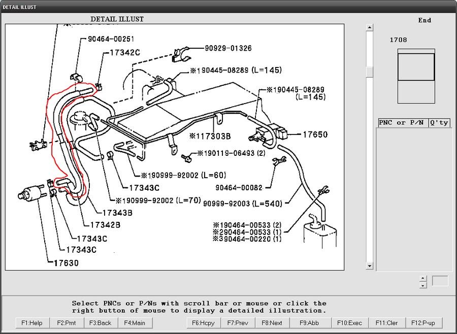

Just a guess, but it could be your idle-up hose connection.
Dave Rose
wa
uzz31 v8
Posts: 479
Monday, September 22, 2008 - 09:42 pm, by:  Dave Rose (Sand_groper) Quote hilighted text Edit Post Delete Post Print Post   View Post/Check IP (Moderator/Admin Only) Move Post (Moderator/Admin Only)
Hmmmm looks like the p/steering air return hose the high vacuum adjusts the pump at low revs to make the steering lighter , its vented back to air cleaner
