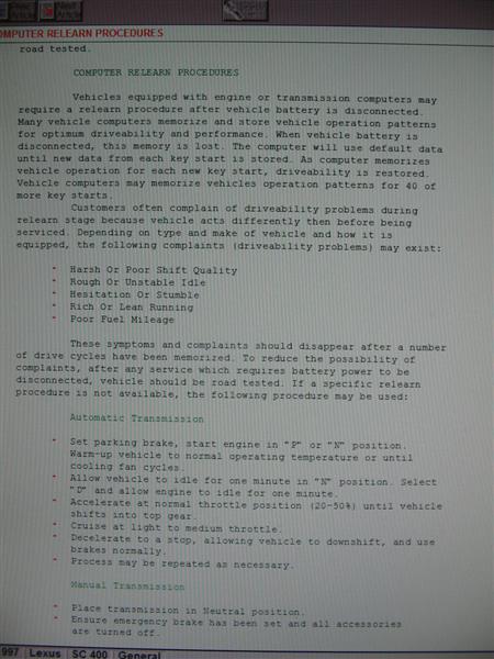

from Lexus sc 400 workshop manual

haha Dave, maybe use the print screen function next time

Yeah well im still a sceptic regardless. It looks like a cut and paste from a manual from toyota engineers about model x, and it states 'vehicles [if in existence presumably] may require a relearn procedure...' It doesnt actually state which model if any have this feature.

The features described do not say anything contrary to my post #3990, although I suspect I may have been slightly misunderstood.
The fact the car remembers about 40 starts supports my view that there is no escape from grannyness if that is how you drive. :-)
Unless you had a genuine problem in the first place, the process of resetting the ECU will have greater impact on how you feel about the car than will the ECU reset itself, and any gain from resetting the ECU will be dissipated as you return to normal driving. Further, even with the ECU in a granny state, a couple of fast starts will help the ECU re-learn without having to go through a lot of other tedious reconfiguration processes, as pointed out by Dave and Mike.

Just a thought. If you have been driving mildly, then do 5 fast starts, the system still has some memory of the 35 previous casual starts.
A reset then 5 starts should mean that is all the ECU knows about.

Ben if you look to the bottom of the photo you will see LEXUS SC 400 its from my w/shop disk.
After a reset the gear change on my car is all over the place for 5ks.
And for some reason the disk will not let me save and send...so i have to take a photo..ah

Sorry Dave i did see that, i was just wondering if the publishers of the workshop manual had actually confirmed the facts. I suppose i am only questioning cos id actually like to be proven wrong ie. how come i dont notice a bloody thing after a ecu reset? :-(
