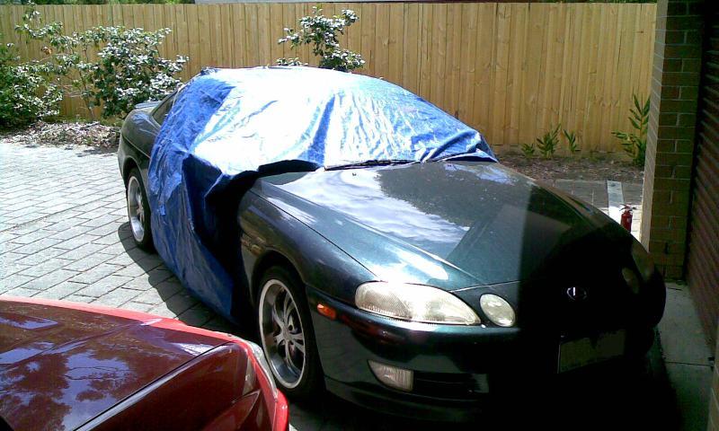

So my car spent the night like this:
Because the key wouldn’t turn, the windows were stuck wide open.

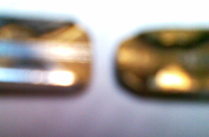

Fortunately the guy I was served by was a good egg. I left it in his hands and came back an hour later. This is the good bit: the blank used is a TOY40, it’s fairly common and shouldn’t cost anyone more than $30 to have cut. Don’t bother looking for blanks because it will cost the same amount to cut. The trouble is the end of the TOY40 keys can become rounded- and this is how they bugger up.
This is a shocker of a pic, but should give you an idea of how the key rounds off.
The locksmith was able to cut a key based on my terrible excuse of a soarer key, without having to use the boot lock- it worked a charm because the end of the new key is nice and flat. Worth noting at this point that if you’re stuck with a valet key, you should be able to take your boot lock to a locksmith and have them cut you a master.

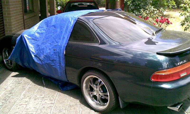

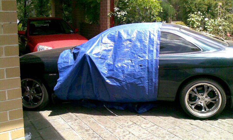

So the car spent the long weekend like this:
Come Tuesday, it took him 30mins and it was all fixed.
