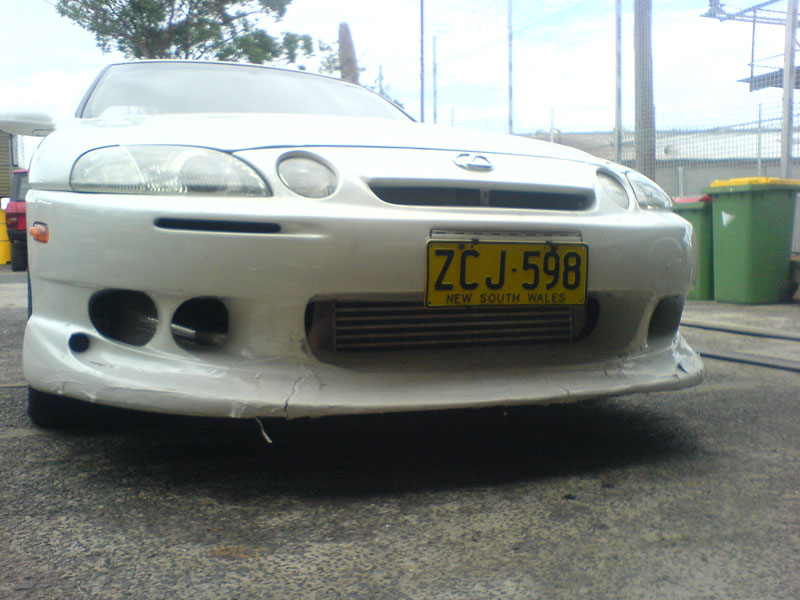

I couldn't care less about what the car looks like at the moment, I mean, look at my front bar:
EBC will go in once the ECU is done, the ECU will be controlling it.
Adjustable cam gears sound like the way to go next and then maybe the HKS cams :-)
