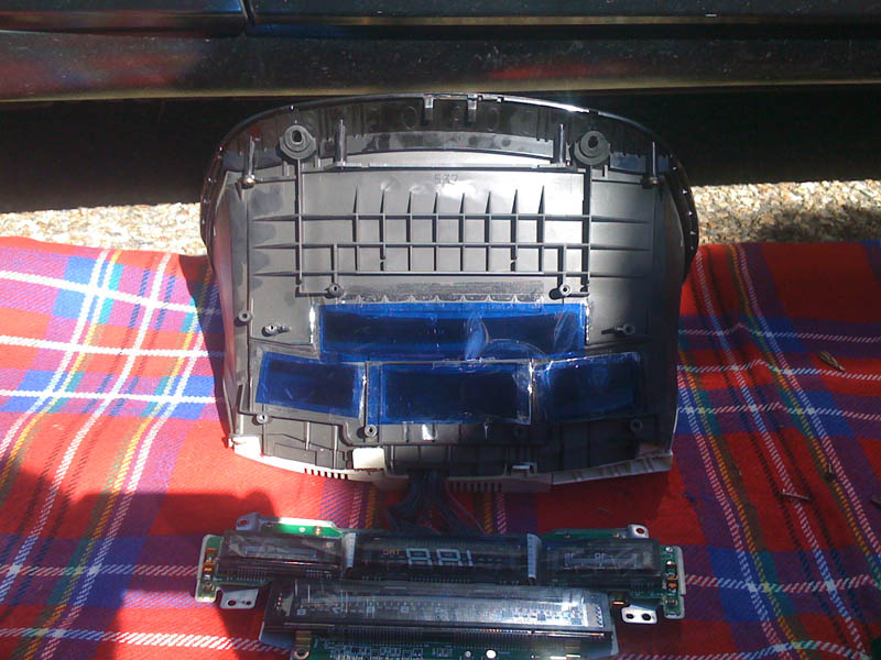

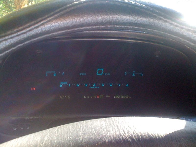

So today i got bored and decided i would have a go at installing the blue dash. I didnt bother getting the kit, instead i went to a stage lighting shop and got myself some lighting gels. Very similar to cellophane for those who dont know but far more heat resistant. I brought a piece about the size of an A3 size piece of paper for $5. I only needed about a quater of it. It was really simple, just cut them to size and sticky taped them down. Only hard part was that stupid orange cord! it was a pain in the ASS! One question though and i know its been in heeps of threads but does anyone know where i can find a tube for the bottom part of the dash that not to hard to fit? anyway hear are some photos! thanks

seriously bruce.. do it yourself man it is SOO easy!
I was a lil worried about when i started to do mine but was blown away about how easy it was and the results i got.
Go buy some different colour GELS and start playing around with them.
As for changing the bottom light thingo, that seemed a little more difficult so i left it and it looked fine anyways.

If you can turn a socket wrench, turn a screw driver and bother to search the forum for instructions, you can do it. IT IS EASY!
Anybody in Melbourne, I've got a whole roll of that blue 'lighting gel' that I got from a audio store, I'm happy to give to cut off a portion free of charge, given that you have to come pick it up.

Yeah now i have the blue dash i have noticed its pretty intense at night! i have had to dim it a little. I like the blue though looks cool. Thanks to James Harris for the inspiration to do this! but yeah for those interested the shop in Brisbane where i got the gels from is called Brisbane Concert Lighting,

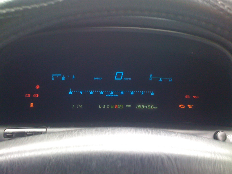

Saturday, June 20, 2009 - 09:29 am, by:  Steve Dickson (Stevedeez87) Quote hilighted text Edit Post Delete Post Print Post   View Post/Check IP (Moderator/Admin Only) Move Post (Moderator/Admin Only)
Hey Peter, i took your advice on this one as well. When i 1st did the cheapo blue dash conversion my dash was a kind of turquoise color. So today i pulled it out again and put an extra layer on and woolaa! Very nice blue colored dash! Thanks mate!

Cant tell much difference in photos but it looks so much better now!

Lol I tried this last night. I did mine a while ago and it always looked more aqua than blue to me(when I had the light up super high which I like). So I ripped it out last night and tired to put some more layers on. Disaster! I was using cellophane. So I went from 1 layer to 5 layers. Oh Yuk! I got the collar I wanted but everything was all blurrrry. So I cut down the layers and by the time everything got clear again at 2-3 layers, it was not blue anymore it was back to aqua. So ok no worries I will go get some lighting gels from Stafford. Another $5 and lots of time stuffing around cutting things to size which I HATE and it was bloody blury again when I get the colour I want. So I chucked the biggest angry fit at around 10:30pm last night and went stuff it. I have ordered the $35 kit today and will get it next week. That way everything is cut to size or close too, and I know it will be the nice deep blue colour I want with no blurriness. Lets hope all goes well for me as I am OVER IT at the moment. I also hate having to disconnect my battery as I lose all my radio stations and my computer settings :-(
Oh I also will not be putting the tube down the bottom as I have a car dash like the picture above and I like to keep my colours around the auto gear symbols. Such as red for Reverse! Does anyone have a picture of the blue light done behind this. I would like to know if the red for reverse gets turned to blue as well. If it stayed red I would change my bottom to blue too.????????????

Hey mitchell! Sorry to hear you had such a problem with it! Mine was hell bright and like a turquoise aqua color when i 1st had the one layer in and way to bright at night IMO. I pulled it out and put one more layer on and it was a sweet as blue and not blurry at all! Still looks sweet as and cant see anything going wrong wit it in the future! When you have the dash out its a good idea to give the mirror piece inside a good clean! But yeah 2 layers is all you need.
