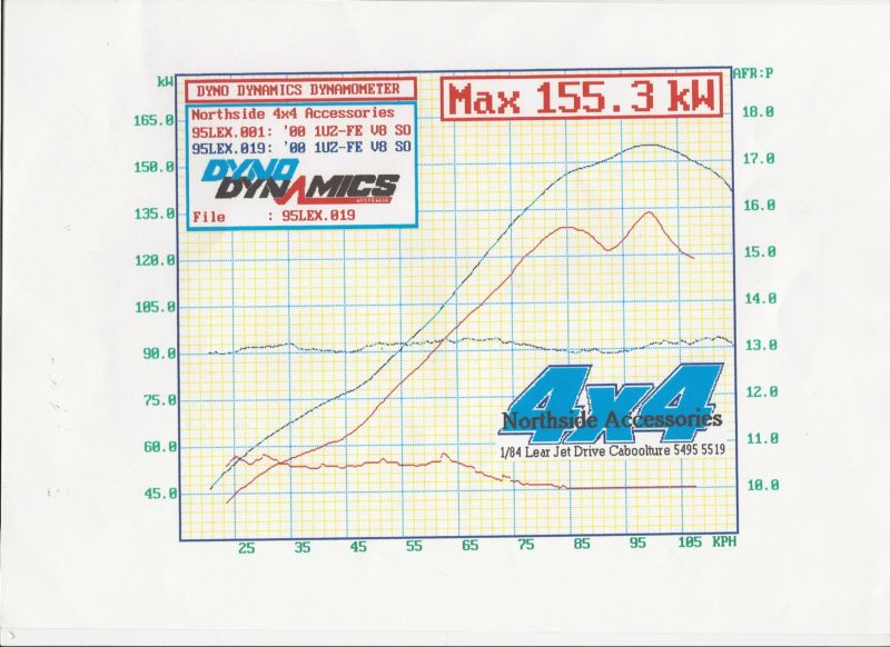

Just got back from the Qld cruise and I was testing out the newly acquired Unichip.
The bastards that fitted it didn't tell me about all the extra tyres I'm going to need now. Crikey, what a difference. I feel the car is now complete. Should have had this much grunt from the word go.

Mike do you have any before and after dyno charts.
Typically there is only a 10-12% gain from tunning with a piggy back unless something was wrong with a sensor or ECU before it was tuned which can result in larger gains correcting for another fault.

Damien, yes I do. Before, 133kw and after, 155.3kw.
David, no warranty as the unit is second hand.
The car has headers and exhaust plus cold air intake.
22.3kw gain which equals ?% gain.

16.8% gain, a little higher than average taking into account passed results.

Damien, for some reason there was a huge hole in the graph (dip) at around 92kph. I don't know what gear they were using, I guess it would have been 2nd.
Also, the AFR went below 10 (actually off their chart). So it was way too rich, especially after about 68kph.
But wow, what a great result.

Humm, they are not normally anywhere near that rich it would suggest you have an issue.

Mike, could you post the dyno chart on here please ?

There you go Adam.

the numbers dont really make sence, the km/h at the end of the scale should be higher, mine does 130km/h in 2nd @ redline, still a tad rich too... but good gains... i might pull my finger out and get mine tuned... im thinking smt-6 though

Mike, your car clearly has issues as they don't run like that from factory.
I would say you are a little above the factory HP output after tunning but you certainly were not anywhere near close to factory power output as it was.

Damien, are you saying that a stock V8 would get near 155kw from the factory? If that is so, I have never seen that stated anywhere.
I am agreeing though, that the richness of the AFR is worse than most in stock form.
Can you tell me what I should have checked out to fix the apparent problem

Mike, I had 149.7rwkw at the last dyno day with just a BFI, in fact the shape of the graph indicates that possibly the electrics were letting it down - spark etc, so it could have been better.
I notice you have a TT diff, does the different gearing have an effect on the dyno readout?

Mike I have seen dyno outputs of 100% stock V8's with over 135rwkw on more than one occasion.
The last dyno day I went to there was a 100% stock V8 Glen's that put down 144rwkw and the dyno power output was fairly accurate based on the other cars that were there and comparing to previous dyno runs ect.
Given you have an engine back exhaust I have no doubt that this could have contribuited to about a gain over stock of 15rwkw. I would think it is possible to have close to that figure 155rwkw with a good 1uz, pending dyno, atmospheric conditions without tunning.
There was also a 1uz that on toymods with engine back exhaust that after piggy back ECU dyno tunning produced 174rwkw. I think it was very high 15xrwkw before tunning and was a gain of just over 10% from memory.
I am not saying a perfect from factory V8 cant gain HP from tunning and I'm sure they can but not much more than 10-12% unless there is something else a miss.
At least to this day I haven't seen it.

Thanks guys, that's all great information but I still need to know what my mechanic has to look at if something is faulty.
It has new leads and iridium plugs, so these should be OK.

I always thought dynoing in 2nd gear equated to a loss of about 15-20rwkw compared to 3rd gear ? This could explain the slightly lower figure Damian ?

one of my many previous cars.... had a difference of 34awkw when run back to back in 3rd then 4th (5speed auto, 4th 1:1) it was 34awkw more in 4th than 3rd...
dyno dude says something to do with the way the dyno calculates the tq blah blah blah and for best most consistant results always run in a gear as close to 1:1 as possible.... 3rd in an auto soarer, but then you have the problem of the speed limiter... so.. 2nd it may just have to be
then there is all the other dyno differences, the place i use uses a Dynamic test systems dyno, and vs other dyno's ive run the car on seems to be more consistant than the dyno dynamics and reads slightly lower with much less smothing on the graph so you can see more detail in the powercurve

Mike at a guess given your power output and no comments about missing I would assume it isn't the spark braking down.
Remote diagnostics is difficult but I would be looking at sensors and possibly the ECU.

My otherwise stock '94 V8 with Rush headers and exhaust put down a bit over 200rwhp (151kw)
The biggest variable here is the dyno itself as Andrew said, however if i got only 130ish kw i'd be having a look at a few things
