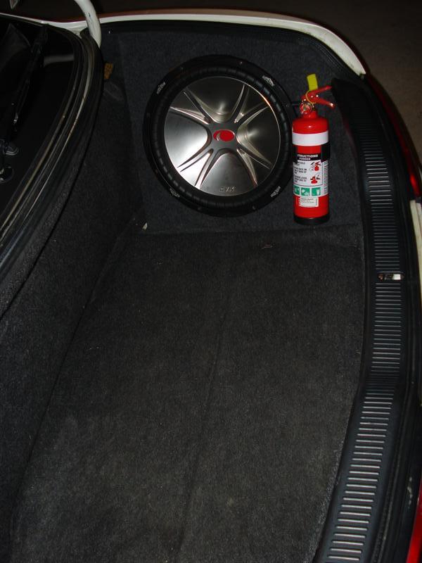

GT Starlet
Posts: 2989
Sunday, August 09, 2009 - 08:00 pm, by:  James Harris (Haro) Quote hilighted text Edit Post Delete Post Print Post   View Post/Check IP (Moderator/Admin Only) Move Post (Moderator/Admin Only)
YES my car was not a track car,
YES i realise its not in an easy to grab spot from the cabin... BUT it doesnt take long to jump out , pop boot and grab it.
Better than having NO extinguisher
