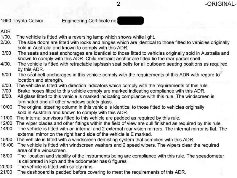

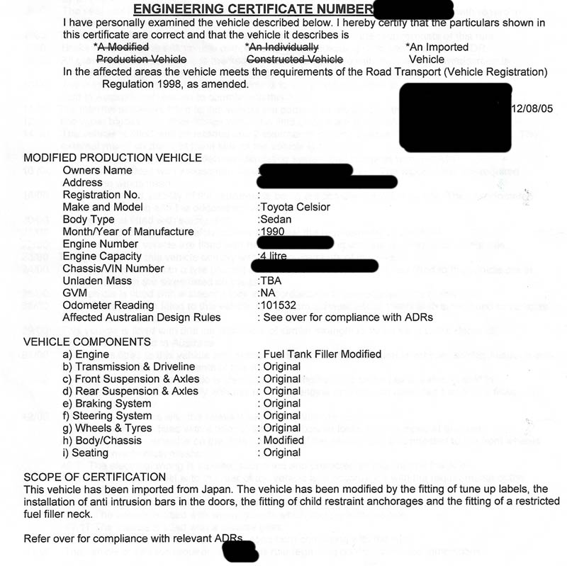

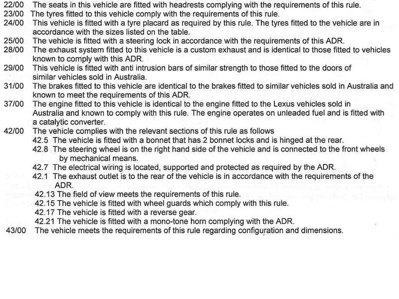

Here's the compliance doc from my Celsior. The Soarer is very similar. This is the exact doc you need to take to the motor registry (in NSW anyway)when registering the car. Im sure there are a few differences for QLD, but this should be a pretty good guide for you.

Tuesday, September 22, 2009 - 09:43 am, by:  Mark Tierney (Mark_t) Quote hilighted text Edit Post Delete Post Print Post   View Post/Check IP (Moderator/Admin Only) Move Post (Moderator/Admin Only)
I do hope (42/00: 42.8) "that your steering wheel is on the RHS of the vehicle & is connected to the front of the vehicle by mechanical means" ...

Tuesday, September 22, 2009 - 09:47 am, by:  Peter Nitschke (Pen) Quote hilighted text Edit Post Delete Post Print Post   View Post/Check IP (Moderator/Admin Only) Move Post (Moderator/Admin Only)
How old is that compliance document Mark? As far as I know, the fuel tank filler no longer needs to be modified as leaded petrol is no longer available.

Tuesday, September 22, 2009 - 10:02 am, by:  Mark Tierney (Mark_t) Quote hilighted text Edit Post Delete Post Print Post   View Post/Check IP (Moderator/Admin Only) Move Post (Moderator/Admin Only)
08/2005. Yes, you could be right there Peter...things may have changed a 'lil.
They did the mod for the fuel talk filler for this cert, however 37/00 states only unleaded fuel.
I actually thought this mod was for more than just the unleaded issue...related to the safety of the fuel talk sealing to Aust standards?
All in all though, this doc should be a pretty good guide.
