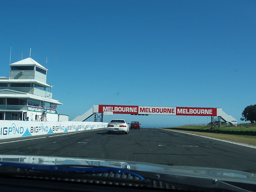

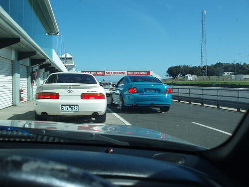

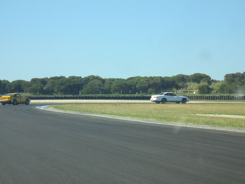

Tuesday, December 13, 2005 - 09:10 am, by:  Daniel Lee (Son_gokou) Quote hilighted text Edit Post Delete Post Print Post   View Post/Check IP (Moderator/Admin Only) Move Post (Moderator/Admin Only)
I went to the Phillip Island cruise with another car club on Sunday and we got onto the Phillip Island race track for 3 "parade" laps and all for free without paying a cent
We weren't given any rules to follow, but i guess is a common knowledge that on a parade lap you take it easy and don't harass the car in front or attempt to pass.
Boy at the track was fun and the Soarer handle pretty well as we havent done any preparation and we though we just cruise down there and watch the boys from the Alpha club race around the track.
Here are some photos:
