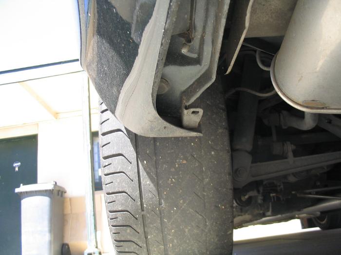

This looked OK from the outside.

so tell me can that be fixed with camber adjustment.or do you have to put some sort of kit in it to fix?cause my old man has a vu ute and some thing is happening,guy told him it has to have some kit put in it costing $600

Part of the problem was that the toe-in bolt was loose. So that rear wheel could independently try to steer a bit. Some wear on the bolt, so am replacing the toe-in and camber bolts when I do the rear bushes hopefully next week.
The other side isn't as bad, but still has some centre wear. I will talk to the wheel alignment people, not sure what the answer is, or if there is one. My previous set of tyres wore the inside of the rears too, yet I get alignments done from time to time.
If I had rotated front/rear more often I would have gotten more mileage from the set, this way I get to play with new tyres. :-)

David, that theory would work fine if you were prepared to replace one tyre at a time and only when that tyre needed it. Then the next and so on.
Mu rear left was the most worn, followed by the rear right, and the front weren't too bad.
I could have possibly just replaced the rear left, or replaced both rears and do the fronts later, or replaced the set.
As I prefer to do the set all at once, if I had rotated them more I may have gotten another 5k (or whatever) out of them instead of ditching 2 tyres that had maybe 10k individually left on them.
I certainly wouldn't replace 1 tyre at a time.
Yes, it does point to a problem, the toe-in bolt had come loose at one point - or wasn't tightened properly, so the left rear was able to self steer a bit.
Now I have the new tyres fitted, I have a new toe-in and camber bolt on the way and they will be fitted along with all new rear VFT bushes from our friend Mr Vlamos. :-)
Possibly overkill, but the bolt has been shaved a bit by the action of metal moving against it and appears to have come loose again - I can feel the left rear step around a bit on bumps etc.
I don't have a need to replace all the rear bushes either, but this car has been so good to me I am rewarding it by replacing the 15yo bushes and hopefully I will get it just about right back to new car ride smoothness.
