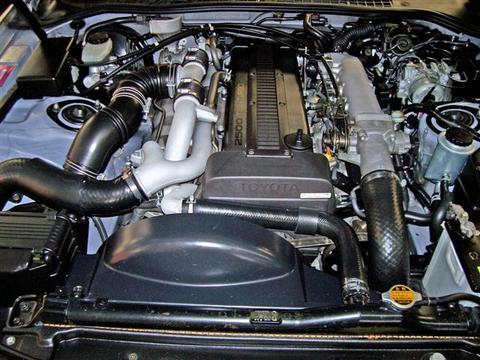

I'm pretty sure Cihan spotted (what looks to be) the repainted engine bay.

Original top tanks are black, and have toyota writing in white stamped on in the middle. The cars not at 70,000kms unless the top tank failed prematurely. Check if the radiator hose has been replaced as the hot radiator fluid spills all over the hose when the top tanks cracks and cooks it leaving obvious marks. If thats the case, they would have renewed the hose.
That engine bay looks like its been resprayed... Pretty obvious dont you say? Its a blue/purple colour for a silver car?

The top tank itself is seperate from the black parts, they cover it once its attached to the radiator.

My soarer only has 75,000km's and I need to replace the top tank of it and as for the engine bay, it might look bluish cause of the camera.. or for the simple fact it hasn't got clear coat. Most silver soarers i've seen have a small blue tinge to them.

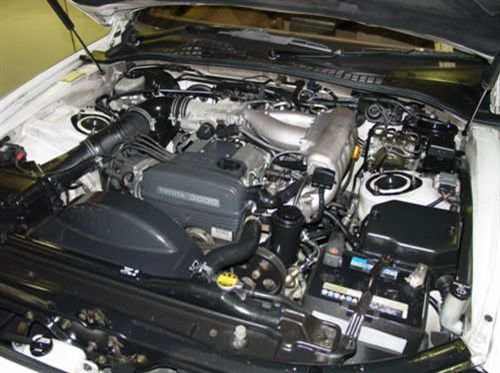

What do you think of this?

That looks original.
What are the kays at?

According to dealer 65k.

How does this one drive?
Does it have the exhaust manifold shielding? The first one with a suspected respray didnt.
My friends JZZ31 has original shielding over the exhaust manifold, off memory its a 94' model.

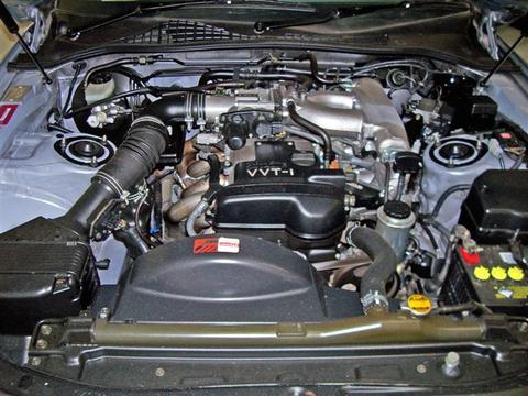

Does this one look resprayed?

Nope...........looks good

Just to learn, how this one looks resprayed.Cihan has some good points though. To me both looks same considering i have little knowledge on these!
Don whats your opinion?

Khan, its highly unlikely that both those cars have resprayed engine bays. I rekon your camera's having a hard time with the silver and its looking very purple when compressed.
Just go out and buy what you feel drives right. Make sure its straight, and mechanically sound.
Thats all you have to worry about really, the rest is all opinionative decision making. Not much chance we can help you without seeing the car for our selves buddy.
Good luck, and sorry if i've caused any confusion regarding the 'resprayed engine bay'. It definitely looked weired to me, and still does! If the top tanks come in that colour then look for white writing with 'TOYOTA' stamped on it, most aftermarket tanks are not toyota original (because OEM stuff is expensive) and are missing the stamp.

I agree with what Cihan says Kahn, but if I was pressed, I'd opt for the VVTi model, as it APPEARS (from the photo) to be in original condition (as does the older one), but I would strongly suggest that you contact one of the more knowledgeable Melbourne members, and if they are willing & able to look at a car for/with you, that would be the ideal solution

Just to add to the confusion, my late '96 VVTi single turbo has the same colour rad tank as Khan showed us in the 2JZ he was looking at.... as someone suggested, maybe MR T changed over in the late '96 period to a sort of poopy, not quite baby s**t brown, almost khaki, but definitely NOT attractive colour (I prefer black plastic myself, pls don't construe that as an invitation to vinyl parties or anything similar)

Hey guys, thanks for all the great tips. pretty much decided to buy the 97 3ltr non turbo. But i will have an inspection done by S&L Cars in Melbourne before purchasing to find any major issues. As i have said before, its stock with no electric seat, no spoiler, no sub woofer, no woodtrim. I believe aftermarket woodtrim would be easy to get. I have offered my 91 V8 LTD+$5000 (dealer asking my V8+$6500) on the road. I guess if i can get in this price, would be a good deal. What you recon?

Oh...its VVTI too.
