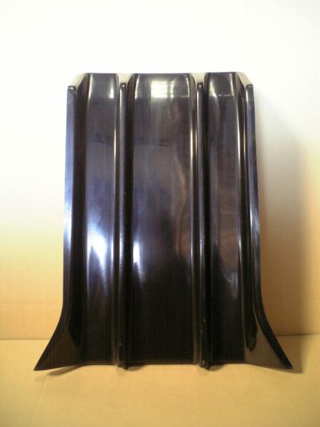

Right, Neil has finally got his act together and is sending me some of these...
For the uninitiated, they are aerodynamic under trays, complete with venturis to direct air where it is meant to go. I will be organising the copying of these items (all things going well) and will have them available for sale here.
What I need to know is how many of you reckon you'd want a set, as that would influence how I make my mould.
At a 'guestimate', these from fibreglass would cost about $3-400, and $6-800 from carbon fibre. These figures may go up or down a bit, a lot, or stay about the same, I wont be able to give a firm price until the mould has been made.
As I said, just looking for eoi, and that's genuine eoi. Not meaning to sound like a prick, but I need to know who many of you think that you'd do this this year. If you're only going to put it on your wish list, don't post eoi here. As I said, I need to know around how many want them so the mould can be made to suit, ie I don't want to make a fully reinforced mould (DAYS involved, not just hours) if I'm only going to make 5-6 sets so this would help me out greatly.

BTW, they's also be supplied as according to the picture. That is it would be up to you to drill the holes for the mounting points in the right places. As everyone seems to have a different front/rear bar, minor shape differences (accident damage, etc) I don't want to pre-drill the holes to suit my car only to have you find that it won't mate up to yours!

So your saying, roughly 400 for the front AND back in fibreglass?
Ide prefer the back only to be honest, i like being able to access my oil filter without too much fuss.
VERY interested
Would prefer a stained black fibreglass

Roughly. Yes, they will be black. Gel coated fibreglass, basically a layer of black resin, same finish as you would have a white boat.
And yes, I will do them as seperate pieces. I'll hive you all more info when I get them from Neil.

Ben, one thing to consider in this is the FREIGHT..
That front panel is not going to be cheap to send.
I have to make some form of timber bracing for it before I can send.( otherwise it WILL get damaged in transit )
It bloody HUGE..
I will try to take pics of these HELD up under a Soarer.
