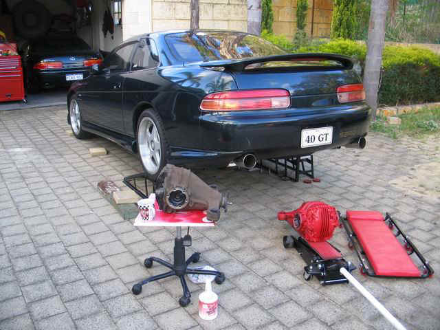

I'm only a weekend mechanic and I did my diff swap on my own the hard way. Interpreted, this means you should be able to too! It just depends whether you get satisfaction from working on your own car verses paying others. It took me a complete day as I ran into complications with my big exhaust getting in the way and I had to disassemble more than I had planned. I just balanced the old and new diff on a jack stand with a board on it as in the photo, so I could align it properly. The rest is pretty much, unbolt and bolt back again ( with the right diff ).
