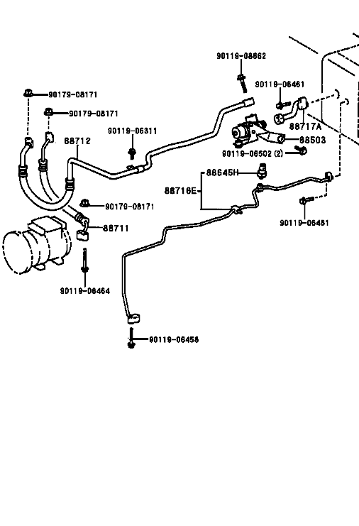

Does anyone have the part numbers for the Suction Transfer Valve for the V8? (the valve sits on the LHS chassis in front of the firewall and is the valve that the small metal hose from the firewall fits into). I also need the suction hose part number (this is the hose from the compressor to the valve mentioned). Thanks

is it in this pic?

No James, it's not in this picture,....I would say the valve is directly below the part on the RHS of the picture you have posted but forward of the firewall. The hose is made up of a metal pipe that runs along the chassis towards the front of the car and then flexible hose to metal pipe fitting on compressor.

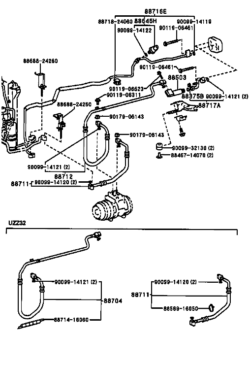

Well i dont have a V8 and it looks different to mine so ill just chuck some more pics up and perhaps we can go from there.

sweet,,, glad someone knew what he was talking about hahah.

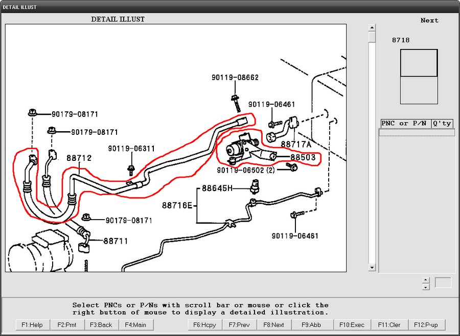

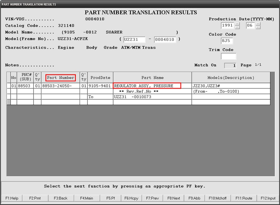

I got a price for the valve #88503 Au$ 701.25 ex Japan.

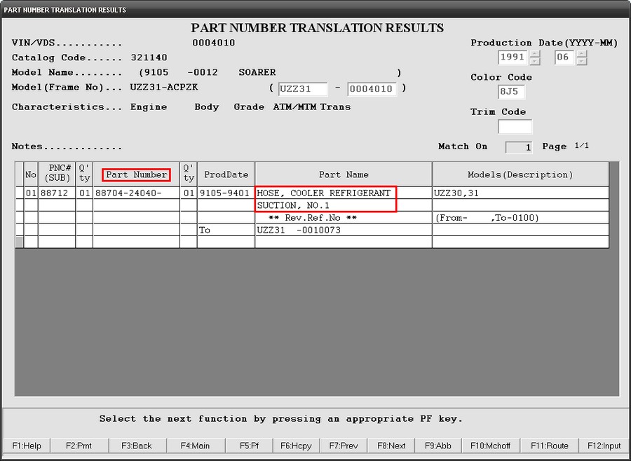

For the hose/pipe #88712 Au$ 159.39 ex Japan.

Thanks for all the pics and details on the part numbers James and Don.....
