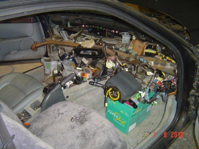

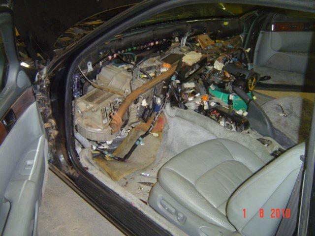

Hi guys, is it possible to remove the heater core without removing the whole dash?

Remove engine, cut hole in firewall with angle grinder. If you're not keen on that, then the short answer is NO
