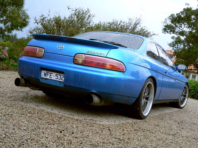

OK Here is my little thread ill post up progress photos of my little build up converting my 92' Auto TT into a Manual Beast!
Now i start off with my current car (the blue one) making 173.8rw/kw at 12psi at the last Dyno day.
Mods so far:
Respray in blue
apexi RSM
HKS EVC 6
old work Miester S2R rims resprayed and polished lip!
HSD coilovers
KKR front mount kit
1.5 stage shift kit from mv autos
DBA 5000 Slotted brakes F&R
fidanza exhaust cam gear
94 tail lights
TRD HID headlights
tanabe hyper medallion dump back exhaust

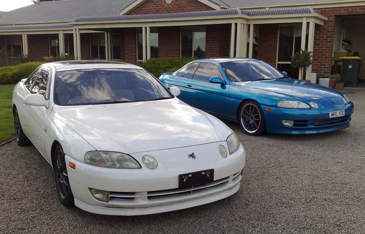

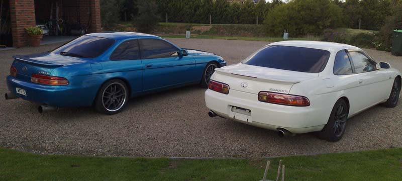

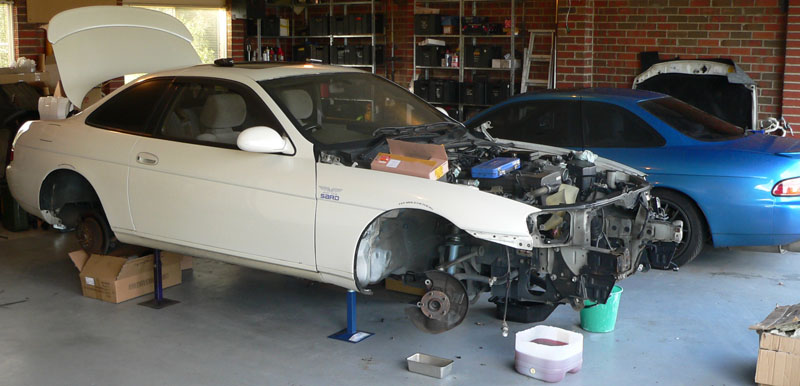

So the next mod is manual R154 conversion and here is the doner! White 93' TT Factory Manual povpak.
I figured to do a conversion it would be easier to have every part i need from one spot! And have some spare bits that can always come in handy as well, so why not a whole car?
So stay posted and ill keep this Thread updated!!

Excellent idea!
Andrew Meiers
Posts: 854
Friday, July 25, 2008 - 08:21 pm, by:  Andrew Meiers (Acmtt) Edit Post Delete Post Print Post   View Post/Check IP (Moderator/Admin Only) Move Post (Moderator/Admin Only)
What are the rims on the donor car?.... offset?
i guess you are going to part it out then?

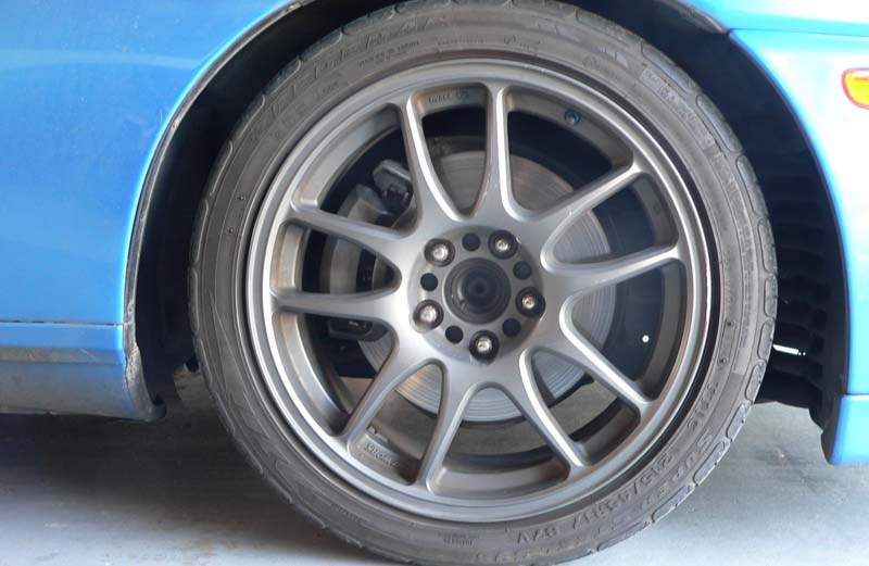

Rims are work something.
17x8 with +42 (IIRC?) and 17x9 +39 I think? It was something along those lines.

Looks like you got some good parts on the donor car - 97 lights, Work rims, R154 etc...
Is the donor car complied or a race import? I have been thinking of doing the same thing lately, but its hard to find a cheap race only import in manual
92 TT , and 93 TT Manual
Posts: 959
Saturday, July 26, 2008 - 07:30 pm, by:  James Johnson (Jamesy) Edit Post Delete Post Print Post   View Post/Check IP (Moderator/Admin Only) Move Post (Moderator/Admin Only)
Andrew as you can see i ended up getting that car i was talking about!
Morgan is right with the offset, the rims are "Work Emotion CR Kai"
Its a race import but the shell is a bit ratty so i would prefer to put the good stuff in the blue one and maybe use that for a couple of track days.
plus its a bit hard to drive the car to the track when its not complianced.
ill update tomorrow with pics i have found a couple of cool bits and peices.

ok a little progress! the car is now up on the stands for good and i pulled the front end apart today i did get a little sidetracked playing with Andrew's Celsior brakes trying to make them fit! more on that later.

Were you having issues with wheel fitment using the Celsior brakes?....I noticed the blue car is wearing the the wheels from the donor car.
I might be interested in the seat belts from the white car when you strip it let me know.
Posts: 971
Sunday, August 03, 2008 - 08:16 pm, by:  James Johnson (Jamesy) Edit Post Delete Post Print Post   View Post/Check IP (Moderator/Admin Only) Move Post (Moderator/Admin Only)
yeh the wheels from the donor car have heaps of clearance for the Celsior brakes but the other miss out by only 6mm.

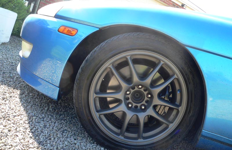

Ok finished my distraction which was these Celsior brakes!!
I fitted them this morning and painted them gloss black to make them look good without going overboard.

yeh they are great, the abs kicks in earlier so i think i need better tyres to keep up with the brakes now!
I found it was easier to bend back the dust protector than to remove it completely.

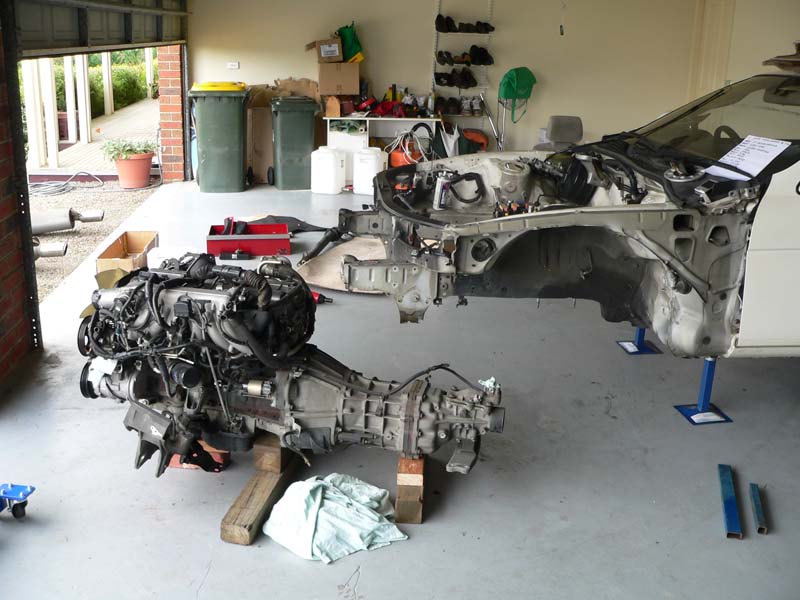

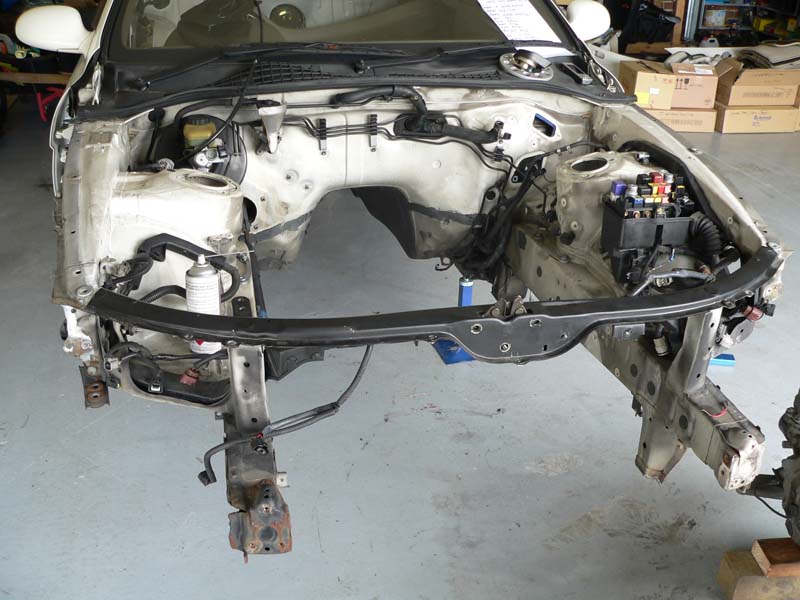

Ok I had a half day on the car today!
made a bit of progress. i pulled apart everything around the engine so it is ready to be dropped out.
also pulled apart all the front suspension components so i can drop the cross member!
I also did a compression test and i got 175psi on all 6 cylinders!! score! its a 110,000km engine and has a brand new timing belt/pump so looks like the previous owner looked after it a bit!
The turbos also look to be rebuilt or newer than the engine ill confirm once the engines out and i can see the back of them.

Sunday, August 17, 2008 - 09:16 pm, by:  James Johnson (Jamesy) Edit Post Delete Post Print Post   View Post/Check IP (Moderator/Admin Only) Move Post (Moderator/Admin Only)
ok more pics even thoe it looks like not to many people are interested.
I had fun removing the engine, i did it with two jacks and dropped it strait down then slid it through the front of the car. i had to chop the radiator mount.
Andrew Meiers
Posts: 867
Sunday, August 17, 2008 - 09:21 pm, by:  Andrew Meiers (Acmtt) Edit Post Delete Post Print Post   View Post/Check IP (Moderator/Admin Only) Move Post (Moderator/Admin Only)
Well i am impressed. Good work .
How easy is it now to get that clutch line off. with nothing in the engine bay.
The inside of that gearbox looks like a black hole!
