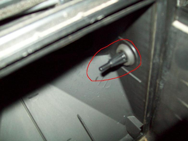

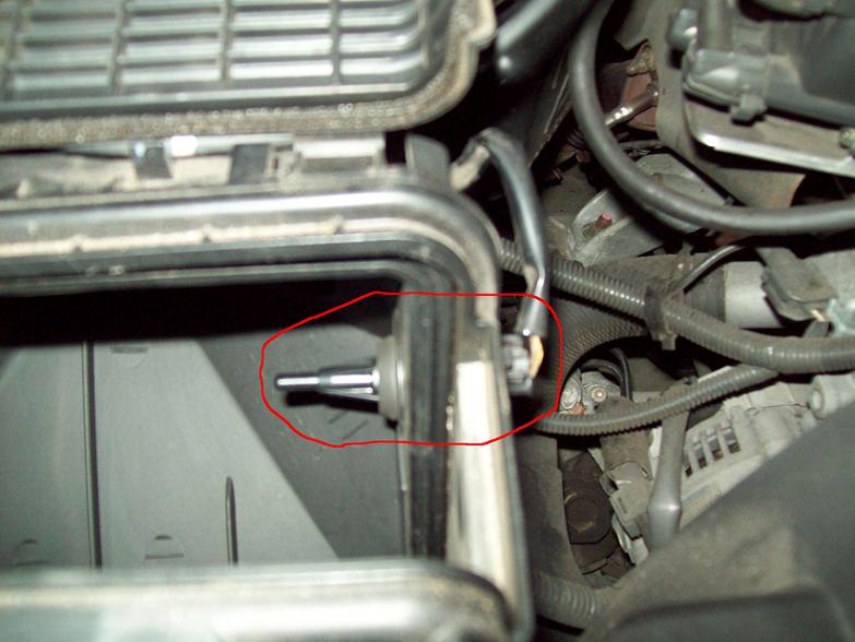

Hi can someone please tell me what this is in my air box please!!!
I was about to remove the air box and i saw it so i don't want to touch it until i no what it is, thanks.

Saturday, November 08, 2008 - 08:09 pm, by:  Sean Routledge (Stircrazy) Quote hilighted text Edit Post Delete Post Print Post   View Post/Check IP (Moderator/Admin Only) Move Post (Moderator/Admin Only)
AFM???

Saturday, November 08, 2008 - 10:00 pm, by:  Luke Barnes (Noddy) Quote hilighted text Edit Post Delete Post Print Post   View Post/Check IP (Moderator/Admin Only) Move Post (Moderator/Admin Only)
Intake Temp sensor is my guess..

Saturday, November 08, 2008 - 11:35 pm, by:  Michael Fabian (Mf_sc300) Quote hilighted text Edit Post Delete Post Print Post   View Post/Check IP (Moderator/Admin Only) Move Post (Moderator/Admin Only)
I was about to take out the air box to install a new pod filter but this thing was connected to it. What dose this AFM or intake temp sensor do? Can i install the pod filter and just leave the thing hanging or do i drill a hole into the filter pipe and stick it in there or what?
HELP PLEASE!!!

Sunday, November 09, 2008 - 11:50 am, by:  Maurice Diggler (Mau_rice) Quote hilighted text Edit Post Delete Post Print Post   View Post/Check IP (Moderator/Admin Only) Move Post (Moderator/Admin Only)
It looks exactly like the intake temp sensor I used to have, just unplug it mate and do your BFI.

Sunday, November 09, 2008 - 08:37 pm, by:  Ben Kelly (Ace) Quote hilighted text Edit Post Delete Post Print Post   View Post/Check IP (Moderator/Admin Only) Move Post (Moderator/Admin Only)
havent noticed this in my car, although i had one in my 2000 celica. its a air temp sensor. best to put it back after you do the bfi i reckon.

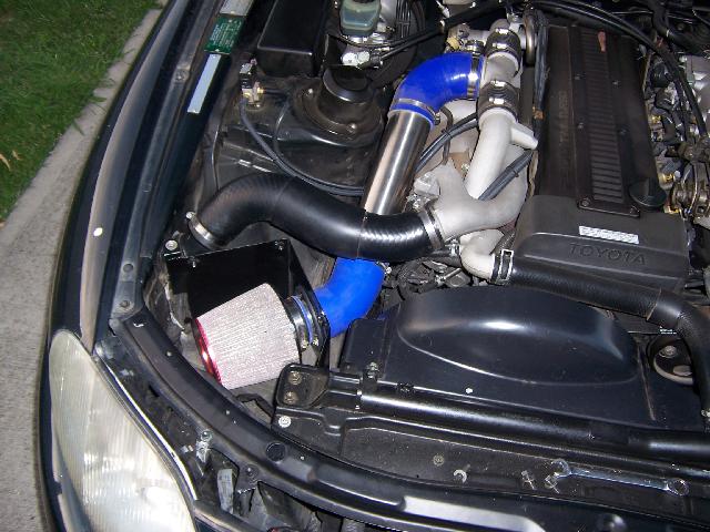

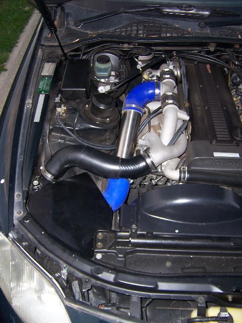

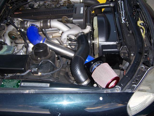

Saturday, February 21, 2009 - 05:40 pm, by:  Michael Keen (Spoilt) Quote hilighted text Edit Post Delete Post Print Post   View Post/Check IP (Moderator/Admin Only) Move Post (Moderator/Admin Only)
hi, i also sell, air filter boxes for pods. bigger and better the bfi intake. cheers
here are some pics
there are some pics for you al cheers :-)

Sunday, February 22, 2009 - 12:19 am, by:  Mike Beck (Gold_40gt) Quote hilighted text Edit Post Delete Post Print Post   View Post/Check IP (Moderator/Admin Only) Move Post (Moderator/Admin Only)
That pod filter setup looks like something you would find from a 1, 2, 3 Dollar store....
If people consider that a 'good' upgrade then great, each to their own.

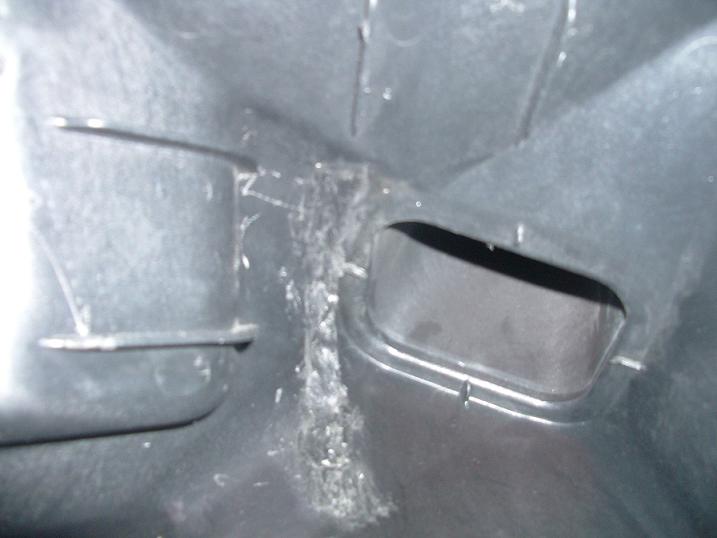

Sunday, February 22, 2009 - 04:54 pm, by:  Sebastian Grant (Saabg) Quote hilighted text Edit Post Delete Post Print Post   View Post/Check IP (Moderator/Admin Only) Move Post (Moderator/Admin Only)

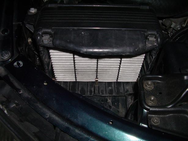

I just completed step 1 of the BFI. Pretty rough job and I haven't sectioned it off yet but already I can notice an improvement in response and high end power. Also noise from the intake and bov is a lot louder.
I also removed the bit behind the air filter that I think is there to restrict intake noise. Before.
After.
It's hard to tell what's going on in this picture but if you've had your airbox out you'll understand. Luckily for me the previous owner had already removed the intake snorkel so it was a breeze to get out but I was trying to remove my headlight by following the tutorial but I found my cooler and piping was in the way. Does anyone know an easy way of removing the headlight in a tt?
